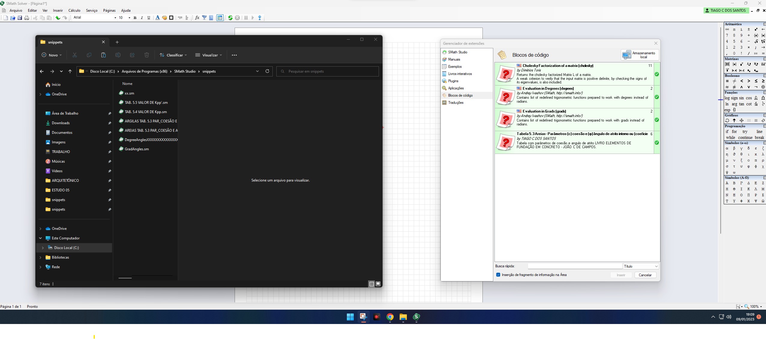

Good evening everyone, I would like to know what is going on with my smth, I have already uninstalled it, restarted the computer, logged out and nothing, see I have 7 snippets but it only shows 4, one of which I did the online download test, someone has already gone through this problem and can you help me solve it?

you should open the *.sm files with a text editor and check the id value of the worksheets. The values must be different or otherwise they are read as different versions of the same file.
If that's the case, simply copy the file content into a new worksheet (CTRL+A CTRL+C in the old file, CTRL+V in the new one)
