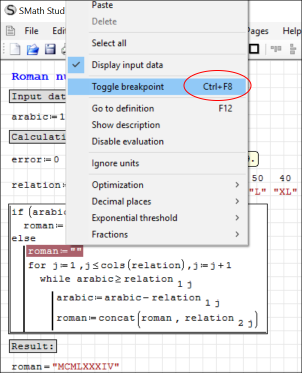

What does this refer to:
"Shortcut key added to Toggle Breakpoint context menu item"
Thanks!
#3 Опубликовано: 20.08.2016 04:46:17
Группа: Super Administrator
Sure. Screenshot added above.
