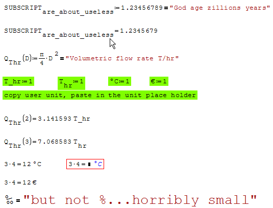

In maths works ang Engineering works, subscripts are confusing.
To me: completely useless, never use. Occasionaly, as short
description is usefull to evidence the RHS construction.
Further, Smath is very limited in the ASCII 'Alt+0key'. Probably
because of the so many languages it was designed to accomodate.
NONE of my Smath Engineering work sheet contains subscript.
