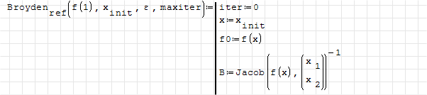

Here is a bit of testing the Broyden plugin. It is a clasical "driving crasy" situation with multiple solutions. It was mentioned by kilele in the link to the document http://en.smath.info/forum/yaf_postsm7678_solve---and-roots-----again.aspx#post7678
Your plugin failed (if I did not do something wrong) but do not worry about it - it is a common situation. The problem is why "Can not calculate" error returned. I do not know. My function returned another solution than few Newton-Raphson iterations or roots(). I also used another software that uses some kind of broyden algorithm and here is the result - the same as roots() returned
>function f(x):=[(x[1]+3)*(x[2]^3-7)+18,sin(x[2]*exp(x[1])-1)]
>x0:=[-0.5,1.4]
[ -0.5 1.4 ]
>f(x0)
[ 7.36 -0.150285529841 ]
>res:=broyden("f",x0)
[ 0 1 ]
>f(res)
[ 0 0 ]
Here is the picture and the sm file
Broyden_testings-1.sm (53,53 КиБ) скачан 2055 раз(а).

The function as in the *.sm file doesn't work because the first approximated inverse jacobian ( B ) is an Identity matrix... i've seen that is a common issue (f.e. root finding methods)... in SMath this could be fixed using the Jacob() function on the user input solution (see the attachment).
Unfortunately the function Jacob() (as well as other functions such as error() function) are not in the 4 standard libraries; I will try to see if importing the library on which it was made by Andrey can be implemented.

1) check for results with the "bad" Broyden method
- if solutions works -> output the results
- if solutions are not closest to zero -> 2
2) check for results with the "good" Broyden method
- if solutions are not closest to zero -> output a can not solve error
the algorithm is similar to that shown in the attachment (replace the B update definition to see the different behavior).

As for the Jacob() function, I thought that Broyden didn't use Jacob directly but an approximation..

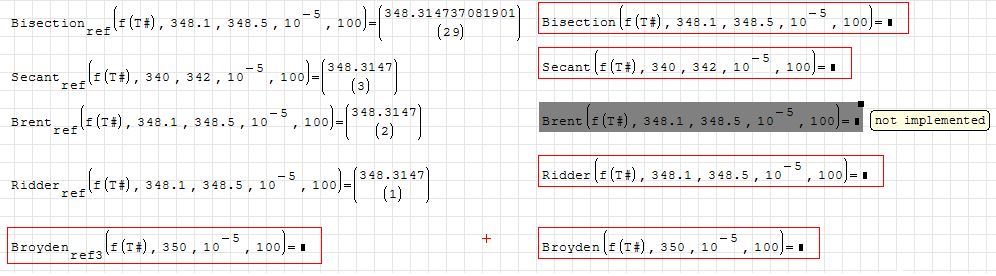

This is one of my working problems I was already mentioned Primer 65a and struggled in SMath with. I reported there the problems of solve() and roots() solutions.
I used it again for testing and attached it to this post. It seems the problem is a bit numerically "tricky" for solving in SMath. The original file is not working in the recent SMath version, neither solve() nor roots() (error message about T as undefined variable - not quite sure why). Here I attached the revised file - just removed eval() I was talking about in the previous post. Fortunately, solve() will now get the more accepted result
Regarding this problem, I am satisfied that at least one of the possible tool in SMath can give the result.
Primer65aa.sm (41,67 КиБ) скачан 2087 раз(а).
Without insight into the nature of the problem, root finding is more or less blind search, this is why I suggested a multidimensional bisection method for a initial guess with just a few iterations.
With some insight into the nature of the root, Newton’s method using derivative information, and Broyden’s method using only function information seem good candidates.

I omorr, i'll check this issue ASAP, especially because in this case the script seems to work while the plugin don't work...
about eval(), you cannot use it where there are undefined variables because the function "force" the numeric evaluation.
