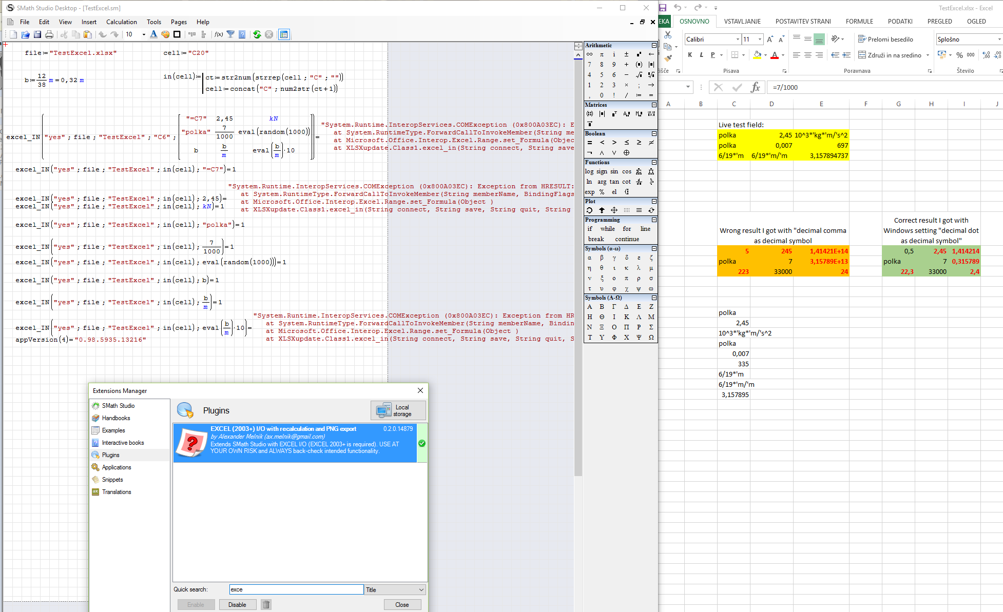

I tried the plugin function excel_IN. I noticed that there is a problem if in regional settings of Windows comma (",") is defined as a decimal separator and number I want to transfer to excel has decimal part. If I switch (only for test purposes -- for my work I must use decimal comma) this setting to decimal dot, everything works correctly. Similar setting in Smath does not matter.
I think that this is a bug in plugin whic causes that internally values are transferred according to Windows setting and not always with decimal dot. Until it is corrected, the only workaround I found is to use function round in Smath to strip any decimal part of values before sending to Excel.
This should be fixed. Test it and report with information I asked for in the previous post if the issue persists.

Please post offending Smath file, xls file, Decimal and argument separator settings from Smath, decimal and argument separator settings from Windows (with directions where to find them - never used comma as my system decimal separator before)
I tried once again. The problem is stil present. Setting of decimal symbol in Smath (I tried with dot ("." ) and with comma ("," )) doesn't have influence. Argument separator is defined as ";".
Influence has Windows system setting. Everything work correctly when dot ("." ) is defined as Decimal symbol and comma ("," ) as Digit grouping symbol. When it is defined vice versa (this is standard setting for many European countries), values in SMath which does have decimal part are treated in such a way as their decimal symbol is ignored (for example 12,45 is treated as 1245).
I use eval function in order to properly treat also values with units (otherwise I got en error))
Here http://www.softwareok.com/?seite=faq-Windows-7&faq=78 you can see how to change Windows system setting (I have Slovenian version of Windows 7 and Windows 10, so above link would be more helpful to you than screen shots from my computer.
In attachment you will find offending Smath file and excel. In Excel you will find also "staticaly entered" values I got in both cases.
TestExcel.zip (7,92 КиБ) скачан 556 раз(а).

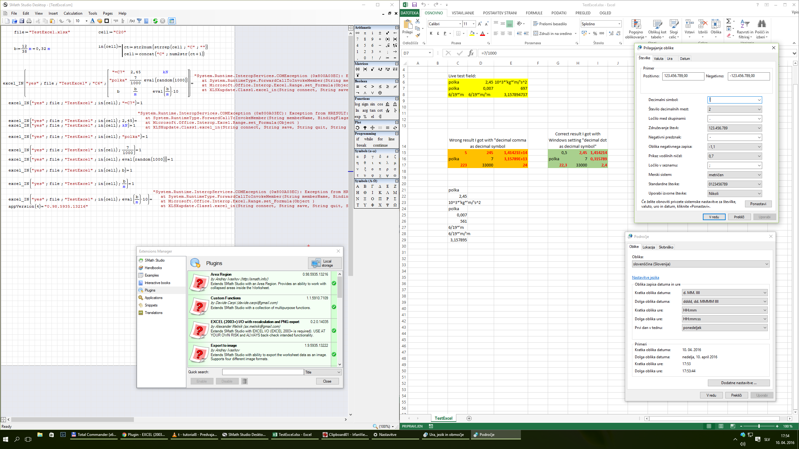

Thank you very much, but I am sorry to report that the test example I sent in previous message produces COM exception when testing with plugin version 0.2.0.14035. The only difference is plugin version. TestExcel.sm file with plugin version 0.2.0.11351 works correctly (but, as expected, with bug), when I change to plugin version 0.2.0.14035, I got a message as you can see below. If it helps: When trying with newer version -- Excel file is opened correctly, after that I got an error in Smath and excel file is not updated. At my computer is quite repeatable -- no other change than plugin version is neccessary to reproduce.
Smath version: 0.98 build: 5935
Excel version: Microsoft Excel 2013 (15.0.4805.1001) 32 bit

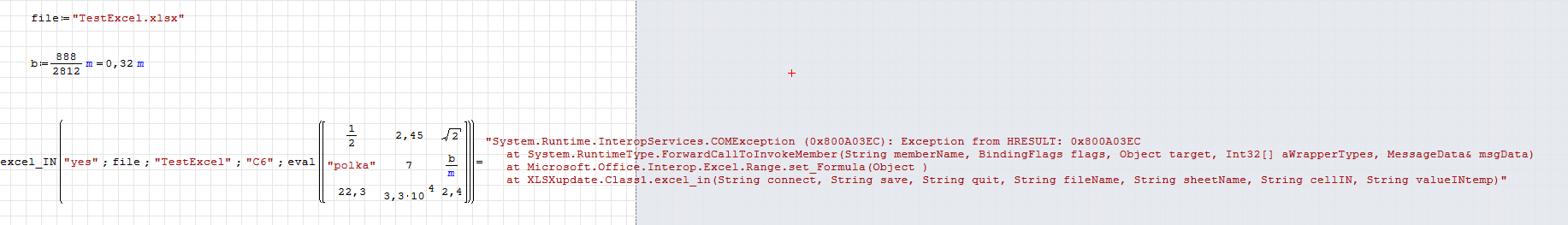

Here are results from me. I tried to give you similar information as you. I don't see any pattern. :-(

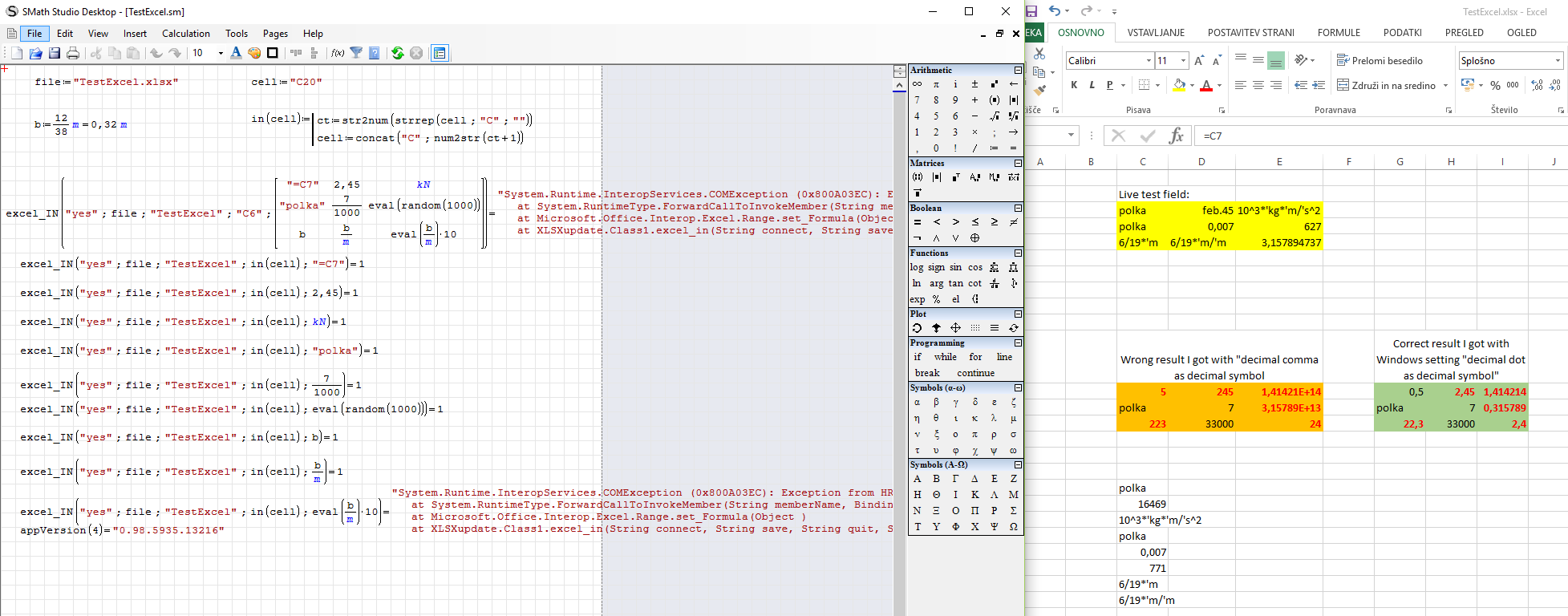

Yes. After I sent a message, I saw this detail. It seems that problem exists when it is neccessary to transfer "real floating" (not fraction) number. Unfortunately plugin version .14879 does not help:

Here is the result. In order to be much clear what is transferred and what is not I deleted target cells in TestExcel.xslx before opening TestExcel.sm. As you can see, 2.45 is reported as transferred, but value in Excel is incorrect. Last value (eval(b/'m)*10 still didn't go through.Test Excel3.png
