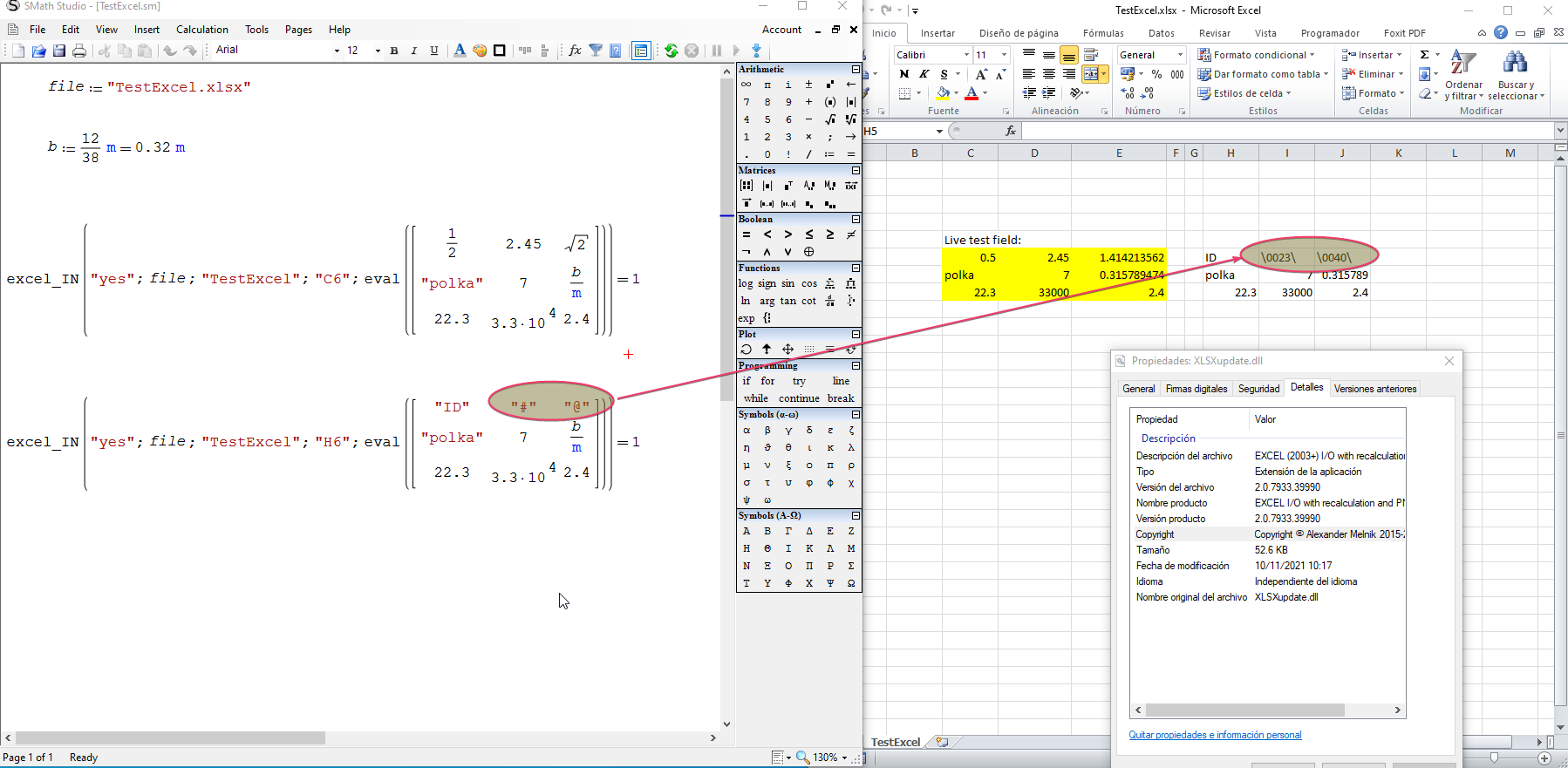

Hi! I'm having trouble sending String variables to Excel.
For instance, ". - / ! ? ;" turns into \002E\\0020\\002D\\0020\\002F\\0020\\0021\\0020\\003F\\0020\\003B\ in Excel.
I'm using most recent SMath and Excel I/O versions.

#110 Опубликовано: 11.11.2021 05:35:29
SMath Studio compatibility
Plugin updated.
Changes:
- excel_in(): text encode issue fixed.
João Felipe Seráfico Melo 11.11.2021 08:48:00, oscar mauricio 11.11.2021 08:49:00

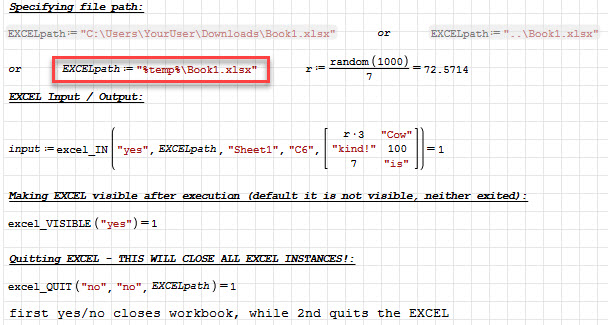

#114 Опубликовано: 03.07.2022 06:10:06
You can use operating system environment variables in the file path.

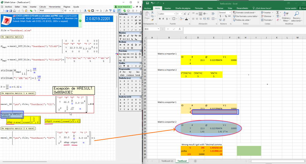

Hello thanks for the plugin, I found a problem in the excel_In() command. I present it in the image, I hope it can be resolved in future versions.
#116 Опубликовано: 08.07.2022 04:45:19
Plugin updated. Please try.

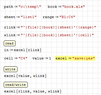

#117 Опубликовано: 08.07.2022 07:01:35
It is possible to simplify the interface. I can add a new feature. You can suggest your own version for a new feature.
