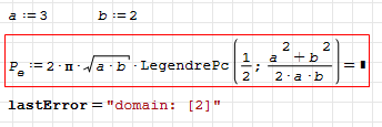

#30 Опубликовано: 09.07.2021 23:42:23
Plugin doesn't seem to evaluate functions.
Gives "domain: [#]" error, don't know the meaning.
#31 Опубликовано: 10.07.2021 01:26:36
SMath Studio compatibility
Plugin updated.
Changes:
- refactored.
This error means that the second argument was out of bounds. The function checks the value of the arguments before calling.
