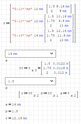

Hello.I have data. I want choosing "a", get only relevant values to choose "b" and output value "c" (if a=10mm; for b there should be options only 1.5 and 2; e.g. selected b=2; means c=8.0mm)

Question 1: How can I do that?
Question 2: Choosing from a list of values "a" with this assignment of the matrix values are repeated. How to avoid it?

You may need a temp data derived from first combobox selection.
And use that new data at second combobox.
Here is your both questions answered.
combobox_question.sm (8,36 КиБ) скачан 1216 раз(а).

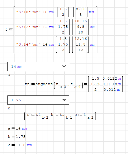

WroteYou can reduce data matrix like this too.
Exactly what is needed. Thank you!
combobox_question.sm (8,29 КиБ) скачан 1260 раз(а).
