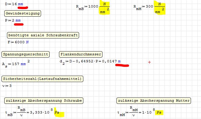

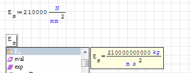

i have a lot of problems with units
if i want mm the program makes m
if i want N/mm2 the program makes Pa
is it possible to defin it ?
how do you do it ?
#2 Опубликовано: 15.02.2016 06:33:02
1 440 сообщений из 2 928 понравились пользователям.
Hello Jonny,
Units in results are by default in base units. You can set the more appropriate units for the single result writing in the rightmost placeholder (wiki: units)
If you are interested to have default output units you can register in the Bug Tracker System and vote SS-1
