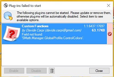

I am experiencing problem in installing CustomFunctions Plugin in SS 6520 (07/11/2017).
Even some items {(such as cases(), abs()}in the Function Index of Reference book have problems.
I am using Win 10 64 bit latest update.
Pl test the attached example.

Confirmed as well,

Thank you, I'll fix it ASAP. As usual please be patient and keep reporting issues
They might be related to the new rendering system. I miss the issues with abs() (not related to CustomFunctions, though), could you post a screenshoot? Thanks in advance.

Thanks David. Following Screenshots(SC) are taken before updating Custom Functions Plugin.
SC 1: Selected Function Index of Reference Book.
SC 2: abs() selected and before updating Custom Functions.
I will let you know the situation after updating Custom Functions.
