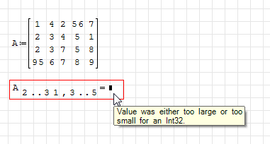

I do not believe such a feature would ever exits in SMath (it does not exit in Mathcad, Prime etc. as well) but I just had an urge to mention this (again). Actually, after such a long time I had to believe it is impossible to just make it real because it would have been made already. For example, if any of you have some time, just read the post from a Guest about 6 years ago (here)
This is very common in other math packages - to extract a matrix from a matrix by having vector indexes. See the picture,
it is clear what we want, but there is an error message. Of course, we can do this by using submatrix(), augment(), stack() function, or by for loop - but it can be sometimes a night mare.

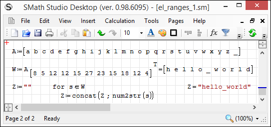

Very nice Radovan
something like this?
el_plus.sm (19,73 КиБ) скачан 1774 раз(а).
Serg 08.09.2016 08:05:00, Radovan Omorjan 08.09.2016 09:45:00, Martin Kraska 08.09.2016 09:27:00

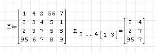

#5 Опубликовано: 08.09.2016 10:26:13
2 344 сообщений из 4 057 понравились пользователям.
Группа: Super Administrator
Implemented (will be available in new build).
Thank you, Radovan.
Вячеслав Мезенцев 08.09.2016 13:48:00, Radovan Omorjan 08.09.2016 10:35:00, Serg 08.09.2016 10:48:00, Martin Kraska 08.09.2016 11:08:00, Davide Carpi 08.09.2016 12:28:00

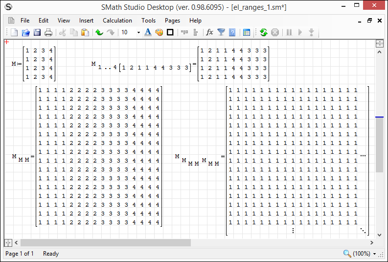

Great. I assume that the feature isn't limited to range()-generated index vectors but can use arbitrary integer vectors.
Might be useful to have some shorthand for using all elements in a given dimension, perhaps an empty placeholder or "all" would do.
This would make the examples even more compact without adding problems for the reader.
#9 Опубликовано: 08.09.2016 12:00:02
I did afraid someone may ask this question. Yes, I didn't introduce any limits there, you can even use matrices:
Not sure what it means, but it works
He-he...
Davide Carpi 08.09.2016 12:28:00, NDTM Amarasekera 08.09.2016 12:31:00, Radovan Omorjan 08.09.2016 12:34:00, sergio 08.09.2016 12:23:00

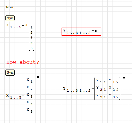

Moreover, my greedy mind does not let me go and bothers me with vector (matrix) indices for undefined variables. Here is the picture
I hope I made my point. The primer goal is to define a symbolic vector or matrix by this shorthand notation

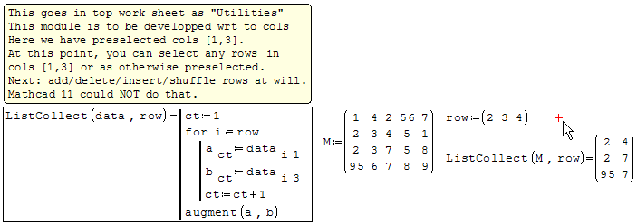

Utilities Matrix RemToDo [select row_col].sm (5,65 КиБ) скачан 1444 раз(а).
Radovan Omorjan 08.09.2016 14:40:00

#16 Опубликовано: 08.09.2016 15:04:58
Sorry for "Mathcaders Primes", Mathcad 11 did it simple because
it supported index [indices] as argment. Smath does not.
Though submatrix look alike between Smath/Mathcad, except for
the indexing, they are not the same ...
Explain: In Mathcad, if you want to mirror a matrix [think of
an image], you just need to reverse the cols order. Smath does
not support the reverse cols order.
If you think others do something useful: YES, but useless for
practical Engineering works involving specific search in matrix
unless the software has been designed for.
When working with matrices [Smath, Mathcad ...] you need a
"Matrix Treasury" of utilities. You will have more than expected
in the attached document.
Thanks Radovan, most interesting subject.
Thank you Jean for the comment, and you are very welcome as always.
As Andrey introduced this new feature, you can just use intrinsic SS possibilities rather than writing new functions like your own, or as Davide wrote few ones in the post above, for extracting the values from a matrix in the way you want. I also mentioned, as you did, that this feature do not have neither Mathcad nor Prime(I think).
Ra
#17 Опубликовано: 08.09.2016 21:30:05

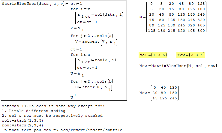

The snipet does it nice, does not work in 5346, and very glad it
does not work. What I need is a function, and designed as such
fully flexible rather than a local result. There is a bit of story
behind "MatrixBlocUser". Mathcad 11.2a [2003] came with the Excel
read function ++++, how many have used/exchanged work in the forum ?
NONE !!! except during the stage of designing DAEP, the collab had
to read "SunSpot" from his own Excel file.
The 3 functions [matrix utilities] have been vital to me, let's see:
The Project Team constructs the pipe data ... so many cols wide, so
many rows long. The piping designer needs certain cols by the rows
of pipe sizes wrt the project. The purchasing department needs other
set of columns, the transport trucker other set of cols ...
and Jean [the Instrument man] needs his own set of cols/rows.
So, everybody is happy with the "MatrixBlocUser".
Utilities Matrix RemToDo [select row_col].sm (24,72 КиБ) скачан 1431 раз(а).

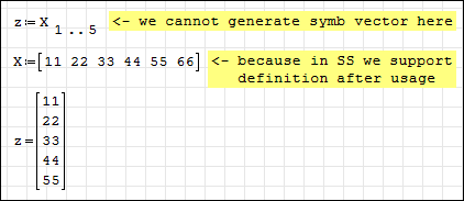

Mike Kaganski
Mike Kaganski
we cannot generate symb vector here
because in SS we support definition after usage
Hm. I just don't seem to understand...
Why isn't possible to re-interpret el(X,range(1,5)) as mat(el(X,1),el(X,2),el(X,3),el(X,4),el(X,5),5,1)? Aren't these expressions equivalent in any case? If value of X is undefined, this doesn't seem to change the situation...
С уважением, Михаил Каганский
#19 Опубликовано: 10.09.2016 05:34:07
Thank you for your comment Mike. I did not understand this as well but had to accept what Andrey explained about it for granted.
BTW, this gave me headache many times when I had to define a symbolic vector, matrix (having the elements in standard notation like mat(el(X,1),el(X,2),el(X,3)...) with more than few variables. I hoped this might be the most simplest way.
There must be something simpler than this, or I just forgot how to perform this in as simpler way

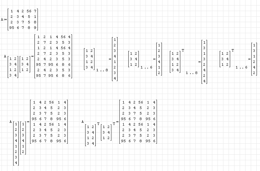

The sandbox example shows the use of matrices as indices. The question is, how the rules for such indices are.
A straightforward rule would be that whatever you provide as index structure, it is accessed by linear indexing from 1..length() of the index structure.
The following example shows that the actual behaviour is different. The index matrices are indexed column-wise and not row-wise as the usual linear indexing works.
I propose to change this in order to be consistent with general linear indexing.
