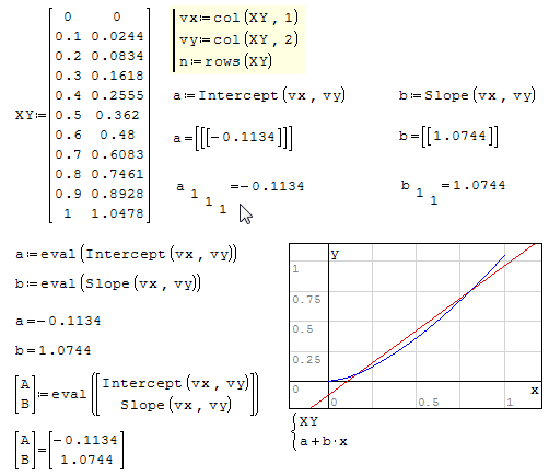

#1 Опубликовано: 07.12.2017 10:26:50
Can't explain to myself double/triple nesting [6179 Win 7].
Bugs SlopeIntercept.sm (10,34 КиБ) скачан 1334 раз(а).

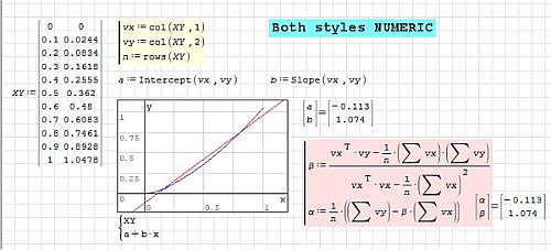

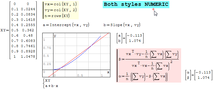

Hello Jean,
something to check in the symbolic engine; change the optimization of a:Intercept(vx,vy) from symbolic to numeric
frapuano 07.12.2017 14:40:00
#3 Опубликовано: 07.12.2017 14:03:58
Thanks Davide ... works fine Numeric !

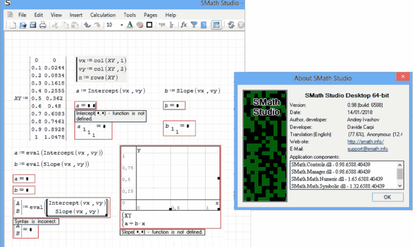

I get these errors when I run the file:
#7 Опубликовано: 16.01.2018 00:23:07
Carlos, try this one [done Smath 6179]
Maths SlopeIntercept.sm (9,07 КиБ) скачан 1258 раз(а).
#8 Опубликовано: 16.01.2018 02:02:49
CBG
CBG
Thanks Jean, but I get the same error.
Is your Smath studio 32-bit?
My Smath Studio 64-bit, does not recognize the
functions of Interception and slope.

Hello!
Jean's example also works in my laptop (Win 10, 64 bit) with latest SS 6588 dated 14/01/2018.
The Functions are in Statistical Tools Plugin.

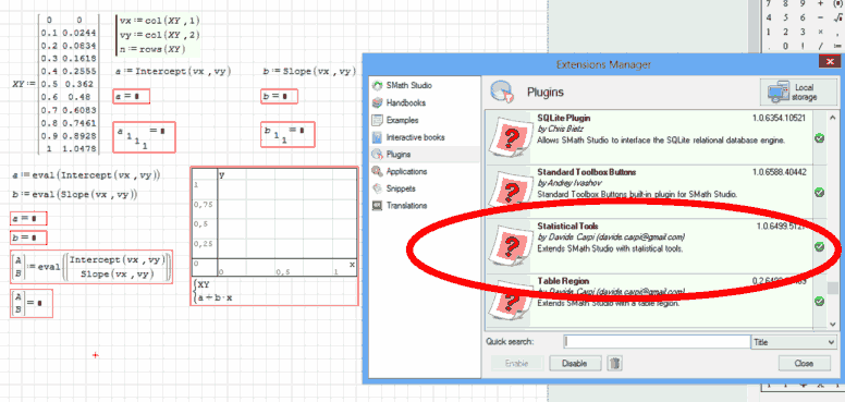

#10 Опубликовано: 16.01.2018 05:36:02
Carlos, do you have statistical tools plug-in installed and enabled?
#11 Опубликовано: 16.01.2018 19:04:34
CBG
CBG
Yes I have it.
#12 Опубликовано: 17.01.2018 04:57:25
I see, trying to figure out what's happening here
