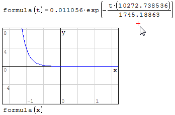

WroteI have a long formula, it will not fit on one line in a standard sheet. I can't see what I am typing, and can't tell if the formula is correct. What do I need to do to see it? If I put a return in the formula, to continue it on the next line, it still does not work.

There are surely ways to simplify/split/compact/collect a formula from foreign source
or from invented construction as understood from your typing.
Examine Hypersurface.
The other long expansion arrive from symbolic expansion [eq(t) from maple invlaplace]
For that one, you can recompose by separating NumDen.
Isolate Num, evaluate the pieces, substitute ... etc.
Recompose the all lot in shorter expression.
The longest expansion I have encountered was 23 pages wide.
There are several ways to skin the cat.
Does it help ?
