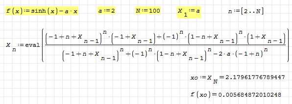

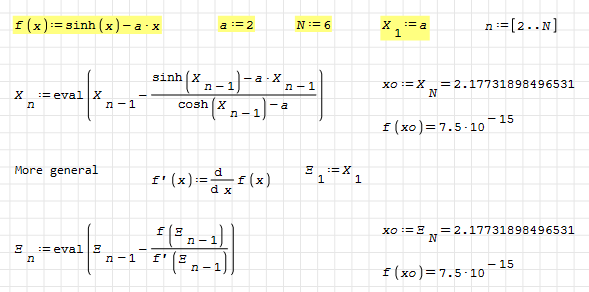

Hi ioan. If we understand 'analytical expression' as 'closed form', the answer is that there is none. But if the objective is to find the real solution, with as many digits as the precision of the calculator used, then it is enough to remember that real numbers are introduced to be able to calculate limits, so this would be a valid answer.
nr-example.sm (9,37 КиБ) скачан 1470 раз(а).

Hi ioan.
Here the root is expressed as the limit of a recurrent sequence as well, but in terms of basic operations.
nr-example 2.sm (14,52 КиБ) скачан 1492 раз(а).

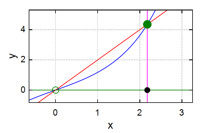

The graphical image of the case is:
It seems that the 4th degree polynom decomposition of the equation, solved without any iteration is enough reasonable; of course, less compact than the solution based on the solve function
Best regards,
Ioan

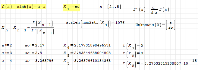

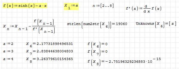

Wrote... This last solution seems resulting with a more modest convergence ...
Yes, it is. But it uses only algebraic operations! This other provide a better approximation using actually only one expression, even it is very long (19060 for the string length)
nr-example 3.sm (9,03 КиБ) скачан 1447 раз(а).

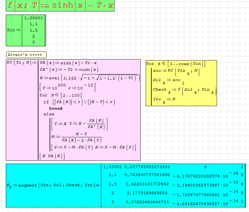

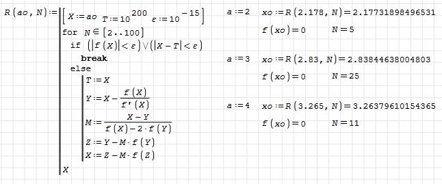

Hi ioan. Dichotomy is always better because it provides an interval of the solution. Here, some other notes:
You're right: the start value is part of the solution, and it requires better attention. This version uses different guess values.
This other is an Improved Ostrowskiroot-finding method, by Miquel Grau & Jose Luis Diaz-Barrero
nr-example 3.sm (19,28 КиБ) скачан 1467 раз(а).

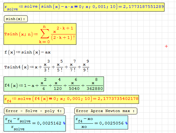

In the appended file, I synthesized my available answers.
Ioan Synthesis 20231002.sm (66,68 КиБ) скачан 1495 раз(а).
Please take a look and make any improvements that you feel as appropriate.
I’m sorry, I hadn’t included too much commentary, hoping that things are comprehensible enough as they are in the context of the whole thread.
I noted a large range of results. However, for my purposes,Ioan Synthesis 20231002.sm (66,68 КиБ) скачан 1495 раз(а). the available results satisfy my expectations. Now I reached “my incompetence level” (according to Peter’s principle) …
I still have another equation bothering my tranquility, but this maybe for another occasion.
With all my gratitude please receive
My Greetings from Paris,
Ioan
Finally, I mixed my raw first approximation with your last findings and here it is:
![2023-10-02[SelectPlus.sm_].png](/ru-RU/files/Download/B4r2dP/2023-10-02[SelectPlus.sm_].png)
