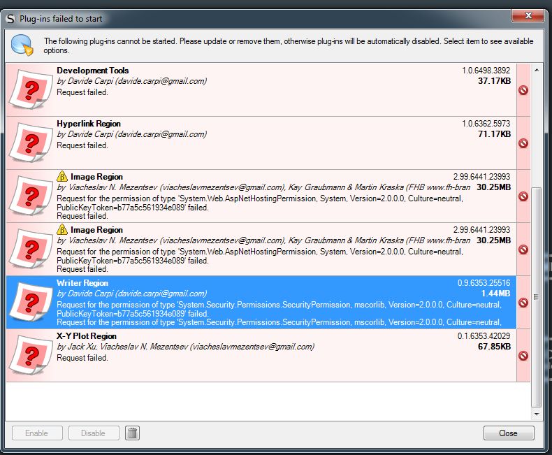

I'm getting the following error when starting SMath
I've tried reinstalling both WriterRegion and SMath itself
I've even reinstalled outside the C:/Programs folder incase its some sort of permissions problem
anyone else having similar issues ?

I've tried the method you suggested , however when I re-launch SS (after renaming the Extension folder) it continues to load some of the plugins.
I'm looking for any other folder that it could be pulling the plugins from but no luck so far.
I've even resorted to removing SS from the PC in the hope of clearing the plugins but its still loading them and when I re install WriterRegion it fails.
I shall carry on looking for a solution
thanks again
