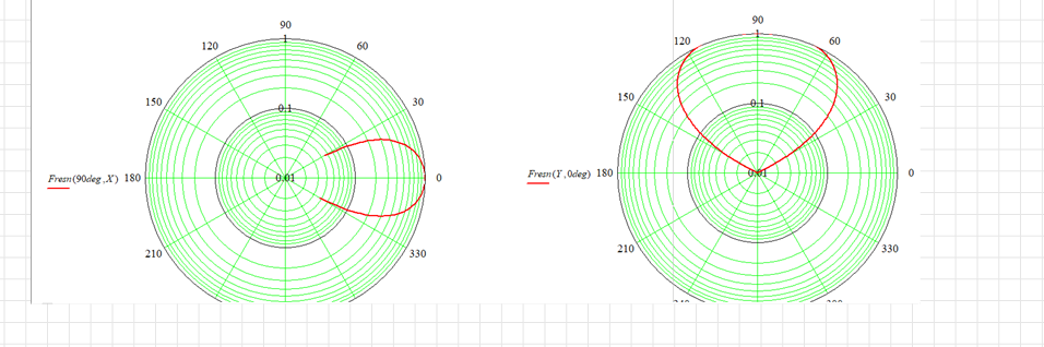

Hello Smath users,
do you have experience or any idea, who to create a polar plot like Mathcad, as shown on the picture?
I need a dB or Log - scale for radius and marking of directions
Thank you for you help.
Best regards,
Andrey

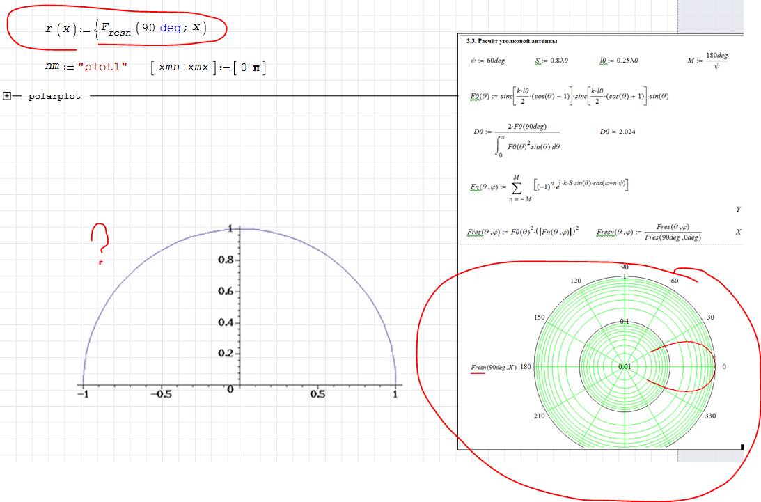

I remember Viacheslav has introduced a polarplot example with maple plugin.
Maybe that demonstration can be a starting point for you.
Link to file:
https://smath.info:8443/svn/public/!svn/ver/3317/plugins/MapleTools/Examples/mapletools.polarplot.sm

Dear SMath users and developers,
unfortunately I did not succeed to create the graph as polar diagram with the help of Maple plugin.
I have tried different options, with Maxima plugin it works, with Maple unfortunately not.
Just one thing. How can I create the polar lines and circular lines (dB or Log20 or Log10) with different step sizes?
A desirable is the one polar diagram as on the picture Calculation of the corner antenna.sm (423,36 КиБ) скачан 1266 раз(а).
That is unfortunately a pity that there is not available a Polar-Diagram set s a normal tool or plugin.

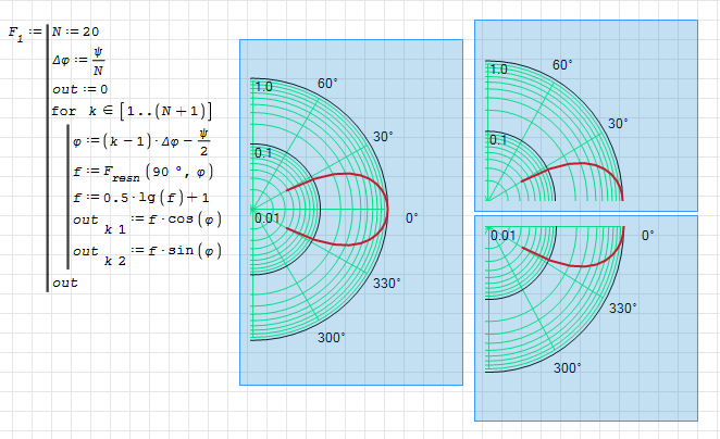

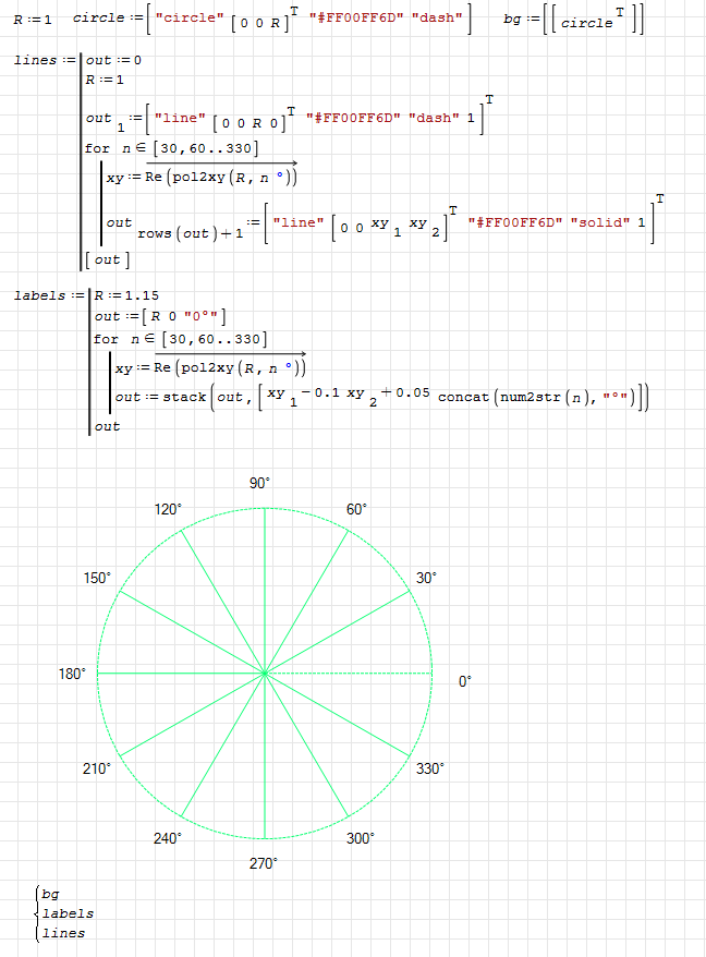

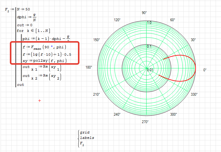

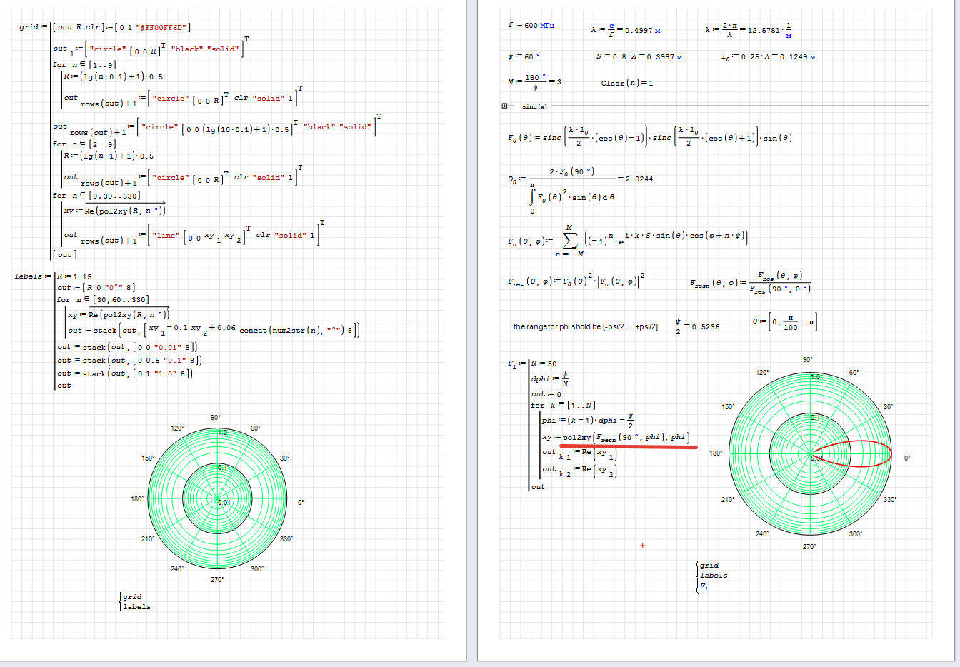

You can use X-Y Plot for this. The function must be drawn with a coordinate transformation in the form of a matrix.
XYPlot. Shapes. Polar grid.sm (11,58 КиБ) скачан 1262 раз(а).
XYPlot. Draw shapes.sm (19,85 КиБ) скачан 3204 раз(а).
XYPlot. Draw shapes.pdf (92,91 КиБ) скачан 2217 раз(а).
#9 Опубликовано: 16.11.2021 09:11:53
Something like this, but you need to display the logarithm of the curve.
XYPlot. Shapes. Polar grid.sm (34,66 КиБ) скачан 1251 раз(а).

Such conversions are fine, but I'm not sure if they are correct.

#12 Опубликовано: 16.11.2021 12:28:00
График можно двигать и ограничивать, используя настройки X-Y Plot.
XYPlot. Shapes. Polar grid.sm (38,47 КиБ) скачан 1198 раз(а).

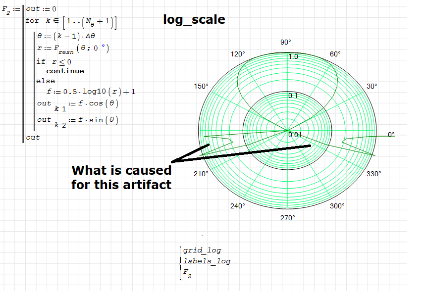

Добрый вечер Вячеслав,
мне все еще нужно обратиться к вам за помощью с Log-Polar Plot.
Я столкнулся с проблемой, как сделать полярный график с логарифмической шкалой для Theta.
Я всегда вижу отрицательное значение r в начале и в конце спискса.
Мне пришлось провести нормализацию и проверки амплитуды на отрицательный радиус перед взятием логарифма, но это не помогло.
Как по Вашему, что может быть причиной такого поведения для графика по углу Theta?
Calculation of the corner antenna_2.sm (499,88 КиБ) скачан 1358 раз(а).
Спасибо, Андрей

#15 Опубликовано: 21.11.2021 19:59:03
Можно так.
Файл не найден. Файл не найден. Файл не найден.

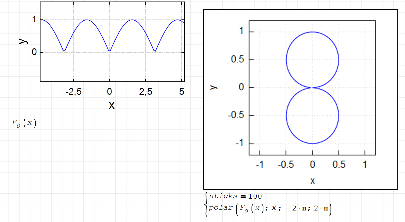

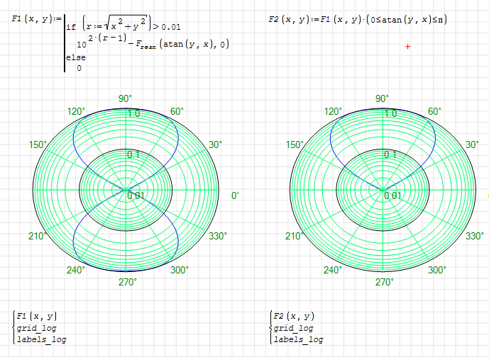

#17 Опубликовано: 23.11.2021 13:19:11
Можно так.
There is there a very mysterious r> 0.01. My explanation is that, first of all, you have to make sure that the argument for log10 is positive, but then you have to verify that in the polar graph it is f> 0, because in polar coordinates only positive values of the position vector module are considered. This implies that f = 0.5 * log10 (r) +1> 0 is needed, from which solving for r we have the mysterious condition r> 0.01.
Addendum:
The original range for the graph is 0 < theta < 180º . Outside of that domain the problem is not defined, or simply does not matter. Viacheslav restricted the domain by imposing y> 0, which is correct, but the following form shows a little more clearly how the transformation of coordinates from Cartesian to logarithmic polar is done, and then imposing the original condition on the domain, so that XY plot just plot in the desired range.
