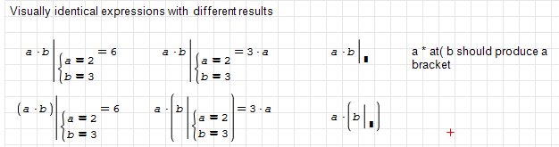

I think that we would need more brackets here in order to make the scope of the at() or the corresponding operator function visible.
