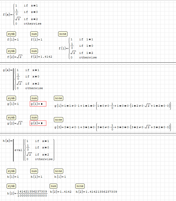

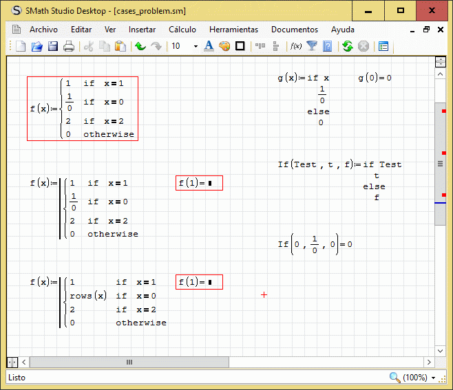

#68 Опубликовано: 29.05.2016 21:31:12
Hi. I guess that args for cases must to be unevaluated, like those if statements above. That's not only for errors, also for improve the speed of cases, which seems to eval all options before give the answer.
#69 Опубликовано: 29.05.2016 22:25:49
Mike Kaganski
Mike Kaganski
I suppose you may want to vote for SS-2316.
As mentioned by Mike, this is addressed under SS-2316. As for now to evaluate only the function for the target condition you have to use eval() inside functions or numerical optimization outside functions.
I can't reproduce the first error shown in your picture, what plugin version are you running and in what SMath Studio?

#74 Опубликовано: 30.05.2016 19:05:53
Hi Davide. In the attached, with background are all errors "division by zero" cases_error.sm (98,13 КиБ) скачан 1654 раз(а).in version 0.98 b5935 (last stable build, as I understand). Plugin version 1.1.5947.155599
#75 Опубликовано: 31.05.2016 04:51:10
Thank you, I can reproduce. This is before the SS-2318 implementation. In this case, you have to switch the optimization to numeric (symbolic uses the boolean sum and SMath ignores that x is a function's argument). If the function is behind a line, you have to wrap it in a eval().
