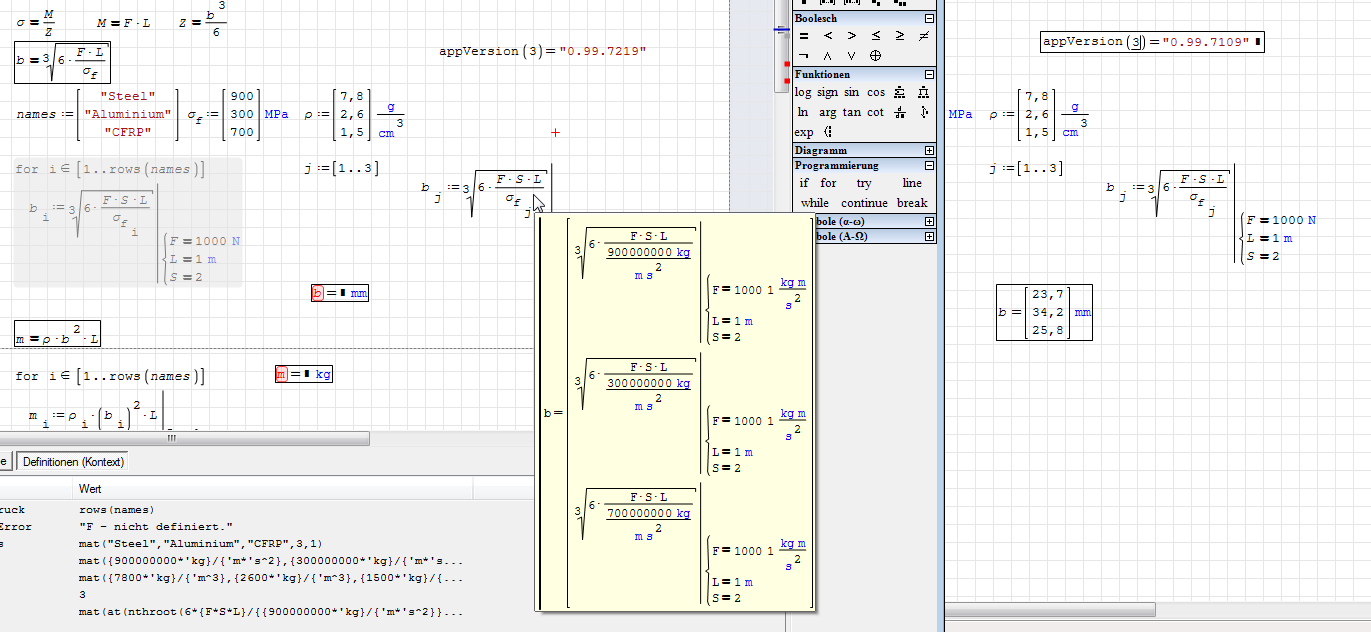

There is a problem with at() in build 7219:
It seems that the function at() isn't executed.
Materials E7-6.sm (10,32 КиБ) скачан 1613 раз(а).
Показать спойлер
#104 Опубликовано: 29.10.2019 13:27:07
Thank you Martin, I will look at it as soon as I can.
edit: fixed in later versions SS

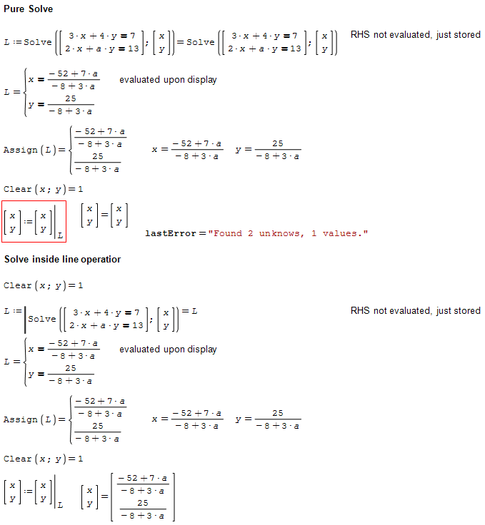

In the attached sheet, the conversion of solution results into definitions is demonstrated in two ways:
1. Usage of Assign(), a function made for this purpose in the Maxima plugin.
2. Usage of the substitution function at() from custom functions plugin, which by syntax should be good for the purpose.
It turns out that it makes a difference whether the Solve function is inside a line block or not. In the latter case, at() comes up with a strange error message.
Solve-3.sm (20,06 КиБ) скачан 1628 раз(а).

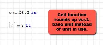

Davide, thanks for developing this plugin; I use several function in here regularly. One that I just tried using that could be very useful for me is the Ceil function. In engineering we often want to always round up, so this would fit that bill well. However, it seems to only round up with respect to the base unit instead of the unit actually used. So instead of rounding a result up to the next inch (or millimeter), it rounds to the next foot (or meter). Would it be possible to account for the unit in that evaluation somehow?
Thanks,
Jason

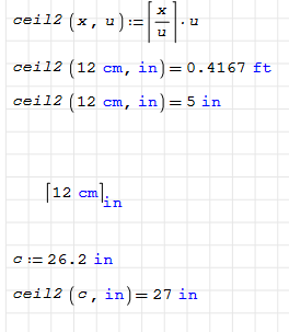

Such a function would definitely need the target unit as input. In order to use this for display automatically, the plugin would need to suppress back-simplification to SI, which might require "Optimization None" on user side. A comprehensible operator form might put a placeholder for the unit at the index position to the lower left
ceil2.sm (3,77 КиБ) скачан 1641 раз(а).

Yes, that looks like it will do what I need. Good idea, Martin. Thanks!
And I like the idea of being able to define the output unit in the index position. That seems clear and streamlined as well.
#111 Опубликовано: 25.03.2021 09:56:13
useful, consistant, I like it... agreed. I'll add it in the next plugin update.

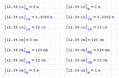

PLUGIN UPDATED SMath Studio 0.99.7739 Nightly Build and later
  • added Ceil(2);
  • added Floor(2);
