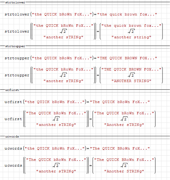

PLUGIN UPDATED
  • added new texts functions:
    • strtolower(1): converts all characters in a string to lowercase;
    • strtoupper(1): converts all characters in a string to uppercase;
    • ucfirst(1): converts the first characters in a string to uppercase;
    • ucwords(1): converts the first characters of each word in a string to uppercase;
    all functions works both with texts or texts nested in arrays/systems;
  • added norme(): unofficial patch of SMath Studio norme() function (BUG shown here);
  • sys2mat(): fixed unexpected influence on input arguments.
Plugin's Sources are moved to the SVN repository (I have added a link in the first post)
regards,
w3b5urf3r

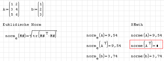

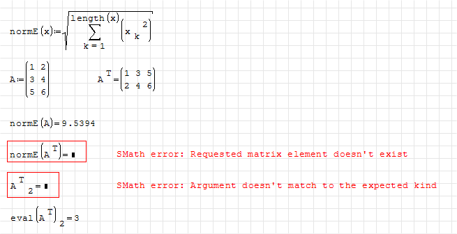

#27 Опубликовано: 16.03.2013 15:59:58
Hi Davide,
thanks for the update. I added the functions to the function reference in the handbook and also added a section on string functions.
The norme replacement is highly welcome. I just had a small problem, see attachment.
Just in case you are looking for distraction from real stuff like unit and systems proof solvers:
I'd vote for unit-proof versions of int(), Re() and Im() and arg().
Martin
#28 Опубликовано: 16.03.2013 16:17:55
Thank you Martin;
the issue is related with some SMath bug involving transpose and the linear indexing feature ... Tomorrow I'll look in the bug section to see if it has already been reported and I'll update the plugin with your formula
#29 Опубликовано: 17.03.2013 07:40:20
PLUGIN UPDATED
- fixed norme() issue involving transpose and the linear indexing feature;
- enhancements of ucwords(): now accept all Unicode white spaces as separator of words.
best regards,
w3b5urf3r
Martin Kraska 17.03.2013 19:50:00

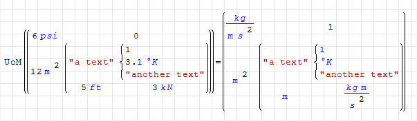

PLUGIN UPDATED
- fixed norme issue with 1x1 matrices
- UoM now get the units element-by-element from any matrix/system (nested or not)
best regards,
w3b5urf3r

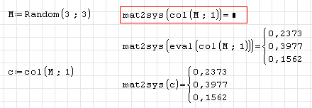

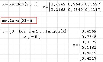

#36 Опубликовано: 27.12.2013 09:29:52
mat2sys requires the argument to be literal matrices. Matrix-valued expressions need to be evaluated first either by assigning them to a variable or by wrapping them in eval(). A similar issue has been reported for sys2mat and has been solved.
I propose to transfer the solution to mat2sys.
Davide Carpi 27.12.2013 20:24:00

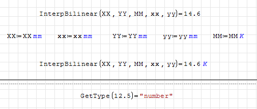

#37 Опубликовано: 01.03.2014 12:12:08
UPDATED
- new function: InterpBilinear()
- new function: GetType()
- mat2sys() improvements for 1x1 matrices
(examples attached in the first post)

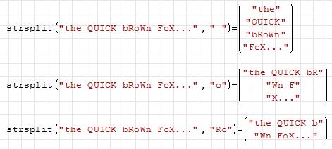

- added strsplit("string","delimiter" )
Best regards,
Davide
ioan92 23.06.2014 06:21:00

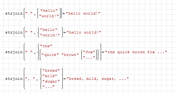

#39 Опубликовано: 23.06.2014 04:17:53
Davide, try string.Join().
Davide Carpi 23.06.2014 04:57:00
#40 Опубликовано: 23.06.2014 05:37:48
Thank you Viacheslav
Done: added strjoin(2)
Best regards,
Davide
ioan92 23.06.2014 06:20:00, Вячеслав Мезенцев 23.06.2014 05:40:00
