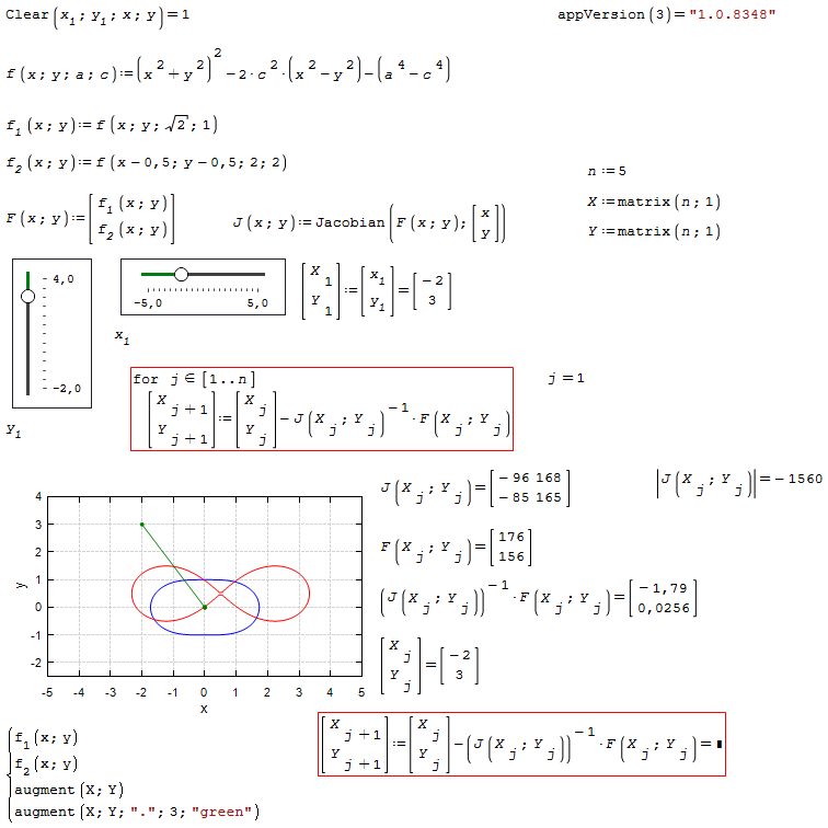

I cannot use the roots function and must use one old good simple method by Newton.
What can you say about it?
Newton-Eng.docx (1,07 МиБ) скачан 969 раз(а).

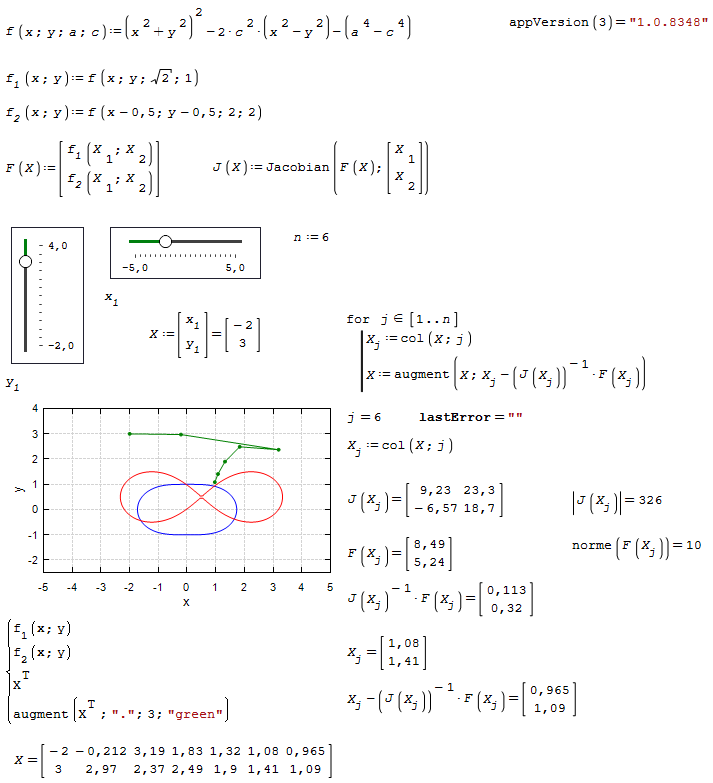

I had problems when reproducing your 2D version. Depending on initial guess I got errors "requested matrix element does not exist". The situation seemed to improve a little by pre-allocating the vectors X and Y yet it didn't become really robust.
So instead of assigning to j+1 elements I used augment() to add new points to the iteration history.
This is the original version:
Newton2D.sm (21,4 КиБ) скачан 1518 раз(а).
And this is the modified version.
Newton2Da.sm (19,03 КиБ) скачан 1641 раз(а).

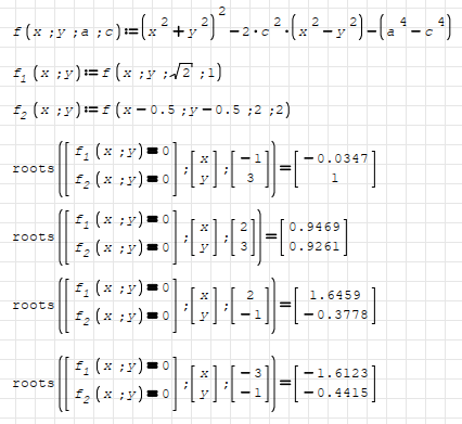

#3 Опубликовано: 09.04.2023 14:27:18
... can't find 2nd root
2nd root confirmed exact.
Solve(f,q,x0,x1,TOL) Copy.sm (162,62 КиБ) скачан 1629 раз(а).

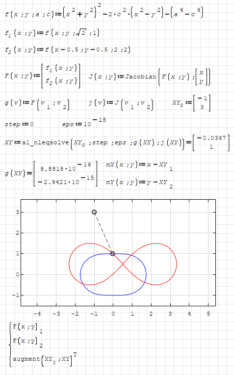

#4 Опубликовано: 09.04.2023 14:33:35
Tried to solve your functions with al_nleqsolve().
Newton.sm (13,85 КиБ) скачан 1558 раз(а).

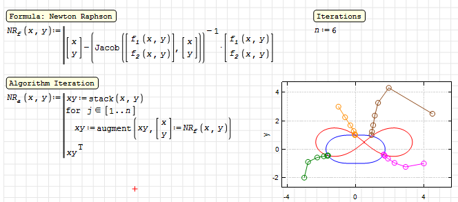

#5 Опубликовано: 09.04.2023 18:19:38
1 134 сообщений из 1 805 понравились пользователям.
Another way, keeping the mathematical formulation and the iteration algorithm separate. As here.
Newton2Da.sm (13,34 КиБ) скачан 1682 раз(а).

#7 Опубликовано: 10.04.2023 16:21:38
Actually, you can.

#9 Опубликовано: 11.04.2023 14:21:16
Two variations added.
Newton2Da. v2.sm (38,35 КиБ) скачан 1632 раз(а).
