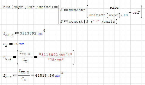

In example below there are a lot of confusing aspects.
I post it for you to show it can be done and check what is done.
It will not work for all situations however.
I will humbly suggest you to not seek showing amounts.
Especially if they contain units.
show_amounts.sm (5,58 КиБ) скачан 1413 раз(а).

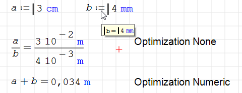

There is an ugly way to enforce storage of the given value "as is" - use the line operator.
Yet the best you get for display is the original numeric value with the original unit converted to base units. I don't see how the latter can be suppressed, yet, it should not be a principal design problem of SMath.
usim.sm (4,67 КиБ) скачан 1450 раз(а).
