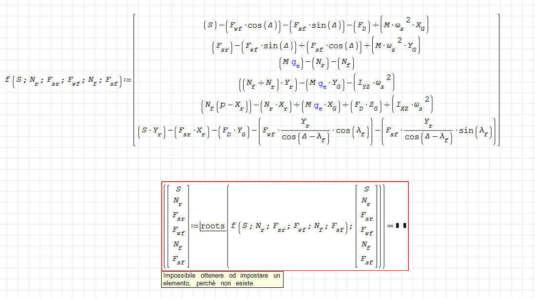

error in a system of equations - impossible to get or set an item because it does not exist - Сообщения

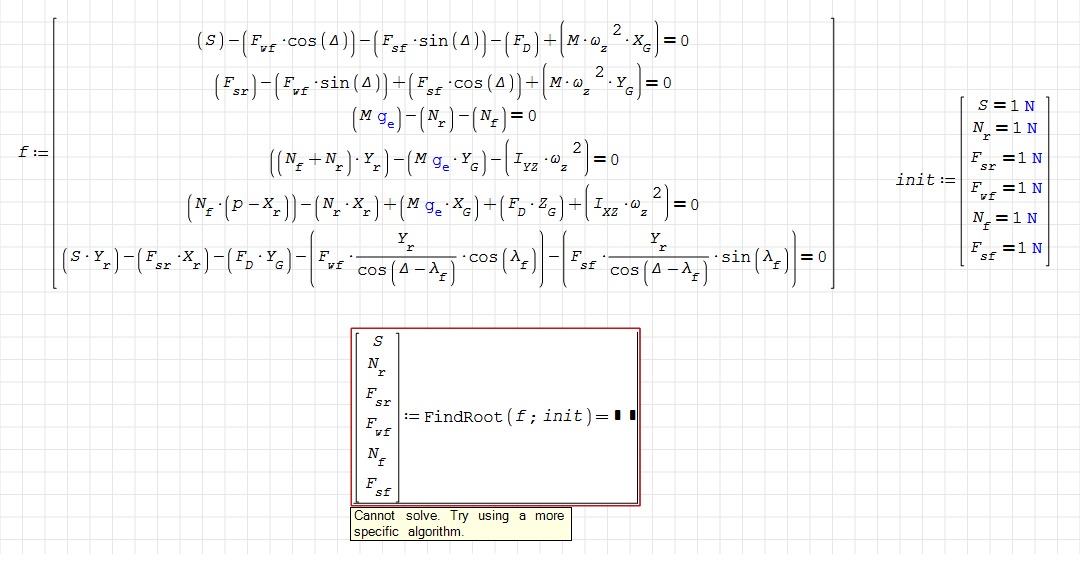

"roots" does not work with the units. You must adimensionare equations, or you can try the other features present in the plugin (eg "FindRoot" present "Nonlinear solvers" plugin)
WroteI tried another function but it still gives me an error...
It's a huge system, and generally does not accept all initials same.
I would zap units first. This kind of solving should have it be
solved from P & P [Pain & Prestige] as it reflects real project
that does come out of the blue. Even Mathcad Given/Find may fail
or pedal through constrain.
Attach the work sheet ... some source reference as well.

it is a system of equations derived from the condition of dynamic equilibrium in the stationary curve motion of a bicycle

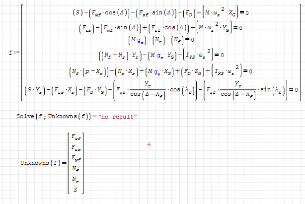

Wrotehere is the spreadsheet
1. equalities [1,2,3] are consistant 'N'
2. equalities [4,5,6] are inconsistant 'mixed units'
calcoli.sm (52,58 КиБ) скачан 1094 раз(а).
You must make the system consitant before attempting solve.

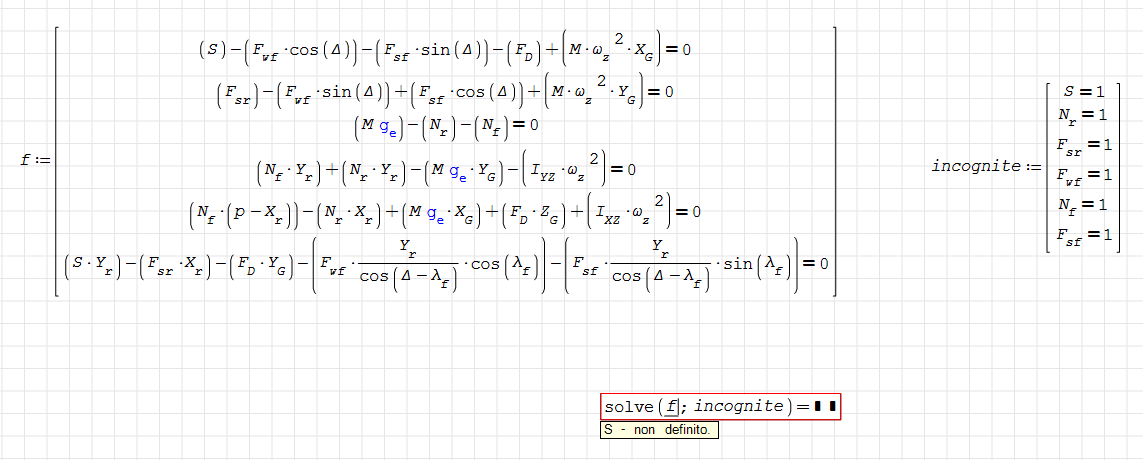

WroteI tried to use the solve function but it still gives me an error saying that S is not defined
Did you read my reply just before your visit ?
WroteWroteI tried to use the solve function but it still gives me an error saying that S is not defined
sorry, when I wrote, I didn't notice your message

Hi, thanks for the reply, but I think I found the error. The system I wrote has two linearly dependent equations, and for this reason it cannot find a solution.
I will have to modify the whole problem.
