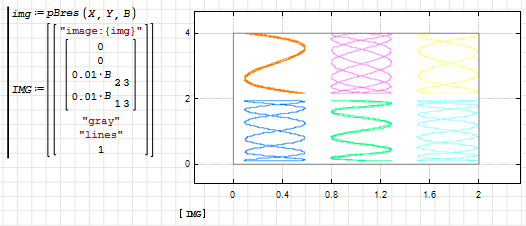

#5 Опубликовано: 03.01.2025 12:21:22
Second life: now it can be inserted into an XYPlot.
BresenhamPlot v3.sm (72,72 КиБ) скачан 1832 раз(а).
BresenhamPlot v3.pdf (320,81 КиБ) скачан 1238 раз(а).
