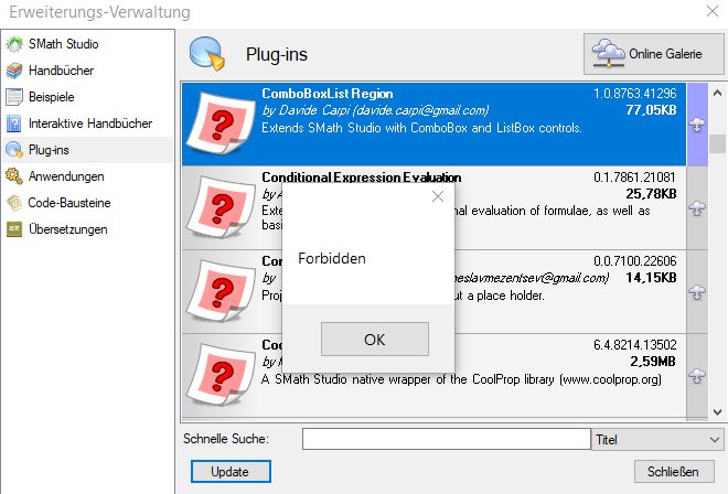

since the new Update i can't update or install Plug-ins. Is it because of the basic version i am using or is there on program error?

Re-login to your account from Smath.
Valid only if account is sufficient.
That should do the trick.

Thank you @overlord. I had to repair the program and now it works.

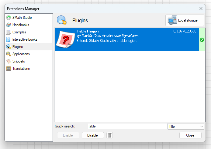

Hello [userlink]Thilo[/userlink]
But one plugin (TableRegion) don't work. Does the TableRegion only works in pay-accounts?
The plugin should work for everyone in the latest SMath Studio, this is the version that should be listed in your extensions manager.
