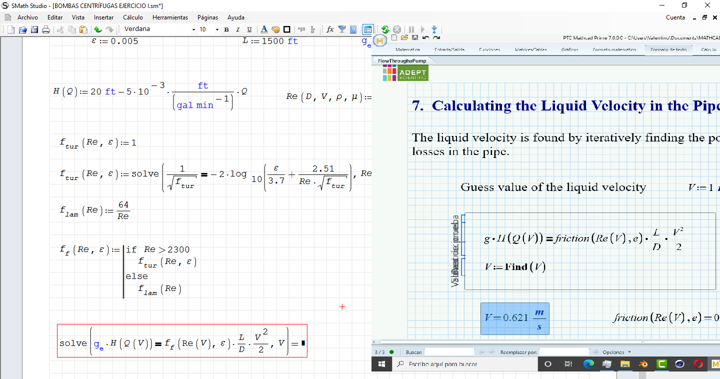

hi guys it's me again xD
There is an exercise to find the discharge speed of a pump in Mathcad Prime ... when I try to do it in SMath Studio I am unsuccessful
Resolving functions based on other functions in SMath Studio - Mathcad Prime
I leave the pdf of Mathcad Prime and the SM File

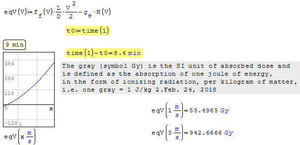

It didn't seem that difficult. Attached as far as I could advance.
Liquid Flow Through a Pump.sm (46,99 КиБ) скачан 1087 раз(а).

Hi. Solved.
Liquid Flow Through a Pump.sm (51,06 КиБ) скачан 1121 раз(а).
Liquid Flow Through a Pump.pdf (126,32 КиБ) скачан 696 раз(а).
