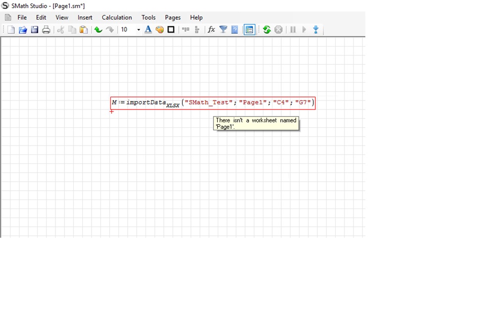

I still don´t get the way how to import xlsx files into SMath files.
It seems, that the xlsx file is found, but there is an error, which sais
my SMath file doesn´t exist.
Would be happy about your help.
Thanks.
G-Tate
#5 Опубликовано: 22.10.2018 12:31:54
Hi Tate. The word unavaible "Page1" worksheet isn't about a SMath file, it's about a "Page1" worksheet in the "Excel workbook" named "SMath_Test" (without extension), which I guess that don't exist too (because the name of the Excel file requires the extension, not only the name).

Try to add the ending to the filname .xlsx and check if Page1 exists
Seems to be that Page1 is not there in the file
#7 Опубликовано: 22.10.2018 14:11:27
If you don't give an extension xlsx is assumed as default; as pointed out by Alvaro and Stefan you have to check if the the worksheet exists in the file

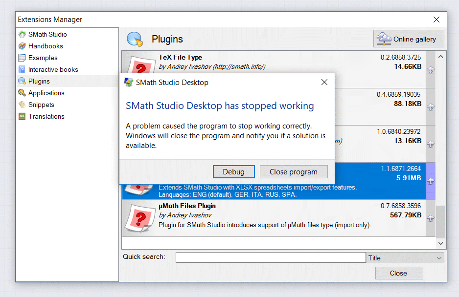

Hello Davide,
The plugin doesn't work with the latest Smath beta.
It crashes right away during plugin installation:
I tried it in office on Win10 and at home on Win 7,
all the same. I'm using 32-bit SS on 64-bit Windows.
Davide Carpi 24.10.2018 12:52:00
#9 Опубликовано: 24.10.2018 12:54:08
Thank you, confirmed.
Latest release deleted.

Thank you very much guys!
I didnt get, that the second name needs to be the sheet name from the excel workbook.
I just tried it with the smath file name.
I should´ve think about it, that the import anyway goes to the actual smath file.
