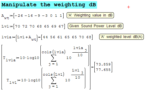

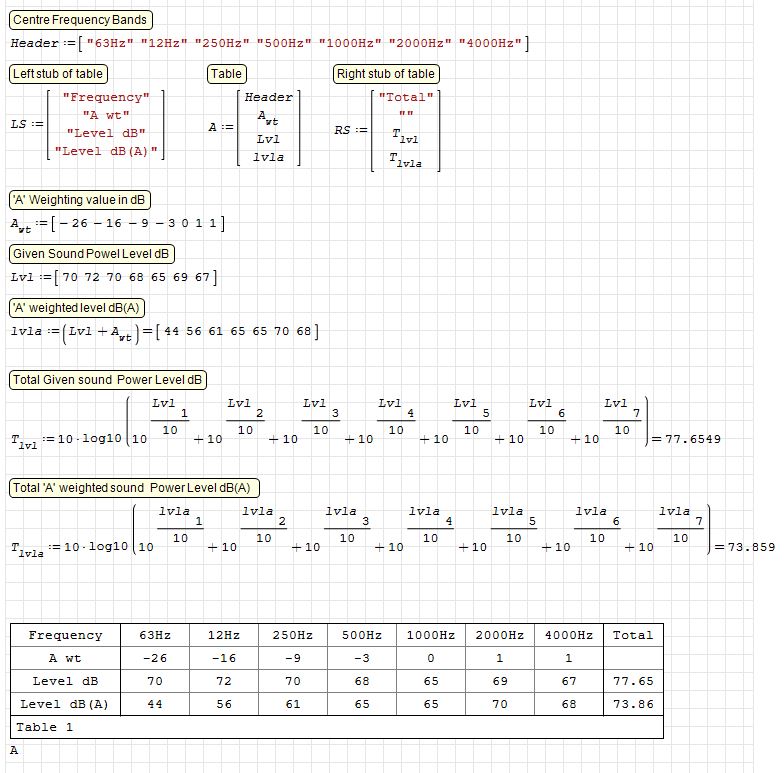

I am trying to work out the 'A' weighting values for sound levels, I have the calculation working, but I would like to simplify the total power levels, by either summation or a loop function. I know how to use summation, but cant get it to work on this.

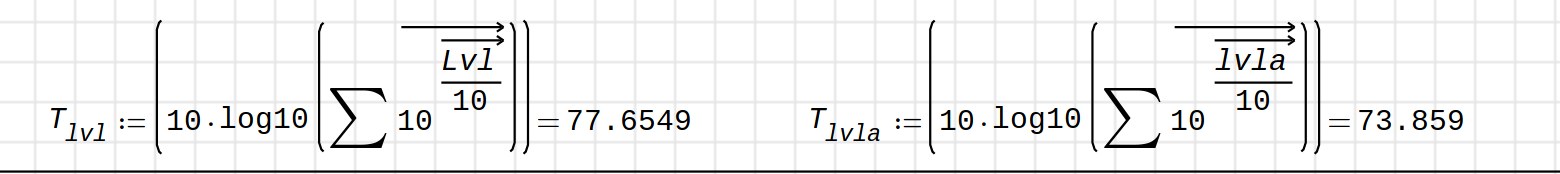

How's this? Using vectorize() function to apply operations to each element in a matrix.
Показать спойлер
acoustics_lyles.sm (14,86 КиБ) скачан 1160 раз(а).

That was exactly what i was looking for thank you.
