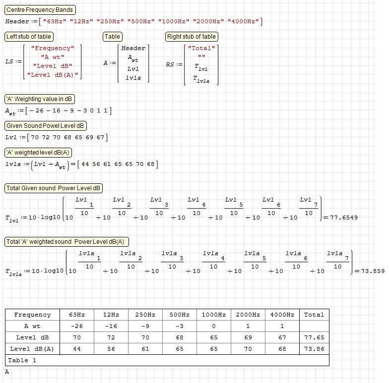

Hi All,
I am trying to work out the 'A' weighting values for sound levels, I have the calculation working, but I would like to simplify the total power levels, by either summation or a loop function. I know how to use summation, but cant get it to work on this.
acoustics 1.sm (17,98 КиБ) скачан 1075 раз(а).

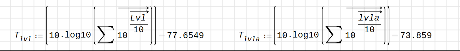

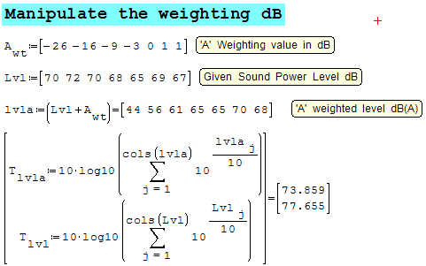

How's this? Using vectorize() function to apply operations to each element in a matrix.
acoustics_lyles.sm (14,86 КиБ) скачан 1065 раз(а).
