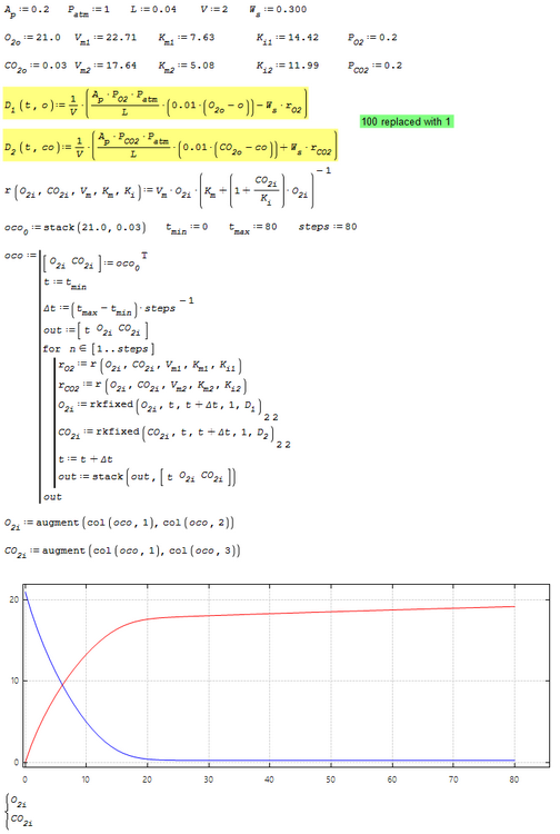

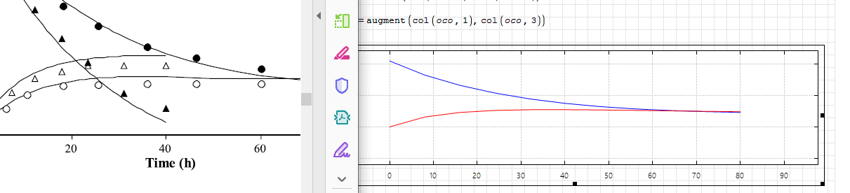

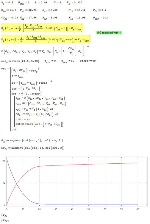

yap, there is something in the data that screwup the ro2 and rco2 evaluation
Do you mean you have red ?
Quite right about dead fruits.
Here in Québec, the most poisoned strawberries ... 0 poisoned blueberries.
The most idiotic are kiwis from New Zealand, they grow in Québec smaller size, succulent.
I was reading the paper Adams-Moulton, to some casual exception, they are all
same ballistic approximation ... dn_GearsBDF runs 5 to 10 times faster.
From the attached, please report if you have red evaluation.
If so, it would indicate a bug in your latest SS version.
At the first eventual red occurrence, please attach an *.PDF to see the guilty.
See you soon ... Jean
No, Jean, do not mislead the man. If something doesn't work, it doesn't mean there is an error. There are alternative probabilities.
#24 Опубликовано: 24.11.2020 15:04:57
I presumed my document didn't work as given.
Let's see what does not evaluate.
Cheers Viacheslav ... Jean

Yup, isn't a problem of code, is a problem of data.
Now I'm trying to make something different for having an idea of the behaviors.
Basically, I would like to evaluate the two respiration rate at different concentrations, 0%, 5%, 10%, 15% and 20%, so to be able to leave it constant in the ODE splitting the curve into 3 portions.
In any case, there is something in this model that I haven't understand for sure.

Ok, after a little bit of scavenging to find the right data, seems that the implementation of uni works quite well!
I have really to thank you a lot for your help, and also I need to understand better how to use gearsbdf and in general all the things that you has write there!
Now I will add other things and reupload the file.
Veniamo da molto lontano e andiamo molto lontano! Palmiro Togliatti

It is possible to solve the system in this way, i.e. integrating each equation separately. But here you need to be very careful.

Euler is still good.
