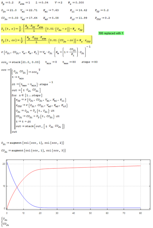

Hi. Thanks Viacheslav for your answer. In the attached, the usual setup for the system of two equations with two unknowns, showing that uni's solution it's the same than the given by Rkadapt. I also can setup a good solution for a 4x4 ode system, but the r's coeffs must to be recalculated before the concentration of O & CO. If not we get a nonsense solution, and guess that this issue is why it's hard to setup a system with more variables, as efus comment that is required. So probably he must to study in which order the updates must to be evaluated for the physical situation.
But what's more impressive to me, it's the Viacheslav intuition for the magistral setup that he do for solve the problem with a runge kutta method with ... one as the step!. Ok, he's the author of the solver plugin, maybe he know what it's talking about.

I wanted a compact and scalable algorithm. You, Alvaro, did it better. It should be remembered that the values of the variables r1 and r2 are implicitly passed to the expressions for derivatives. The solvers also support optional parameters after t and x. You can enter both variables r1 and r2: D( t,x,r1,r2 ). This will make the calculation of derivative values clearer.
For those who are not familiar with numerical methods, it is difficult to describe the problem for the solver. I still can't finish a new solver, where the system can be written in a natural form, like a set of equations. This would make things easier for most typical cases.

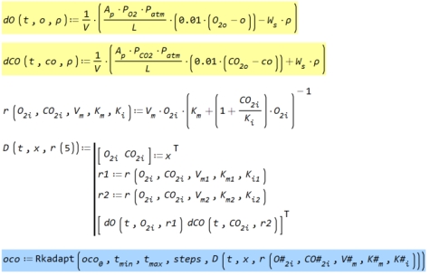

Ok, starting from an example from Viacheslav (Thx really a lot for all your work) I was able to use lsoda for the two and the result is quite good, so I will try to work another little on this road and we will see if I will be able also to add the others pieces.
Edit.
Ok, probably how the system is written isn't the most elegant thing to see, but the loss of weight due to respiration seems to be well represented (green line). The effect of the humidity isn't, at the moment, represented, but with a little bit of work I think it will do.
lsoda MAP.sm (43,15 КиБ) скачан 1078 раз(а).

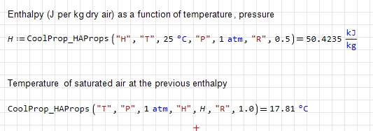

Hi efus. Maybe you could be interested in the coolprop plugin.
Help for humid air: http://www.coolprop.org/fluid_properties/HumidAir.html
Collprop for SMath: https://en.smath.com/forum/yaf_postst7398_CoolProp-Wrapper.aspx
