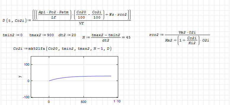

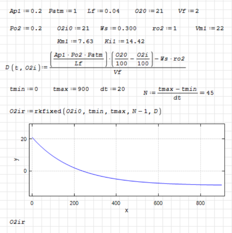

#7 Опубликовано: 23.11.2020 10:34:56
francesco88
francesco88
1 сообщений из 34 понравились пользователям.
Ok, seems that I was able to do some progress here but, obviously, there is something that I think doesn't work
In your opinion this way the value of rco2 change with the new value of Co2i or it remains the initial value that I have set?
Prova modello permeabilita.sm (129,47 КиБ) скачан 1100 раз(а).

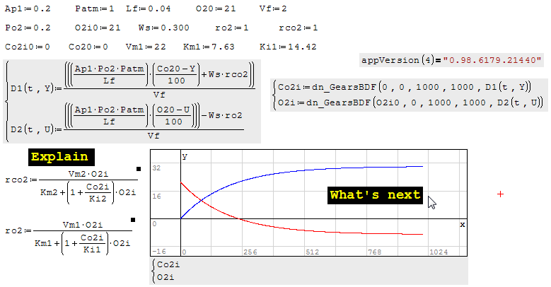

#8 Опубликовано: 23.11.2020 12:18:13

#10 Опубликовано: 23.11.2020 12:45:47

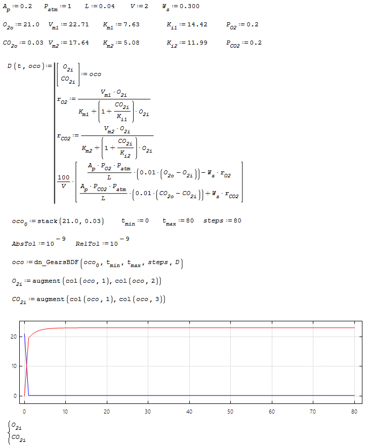

#15 Опубликовано: 23.11.2020 23:55:07

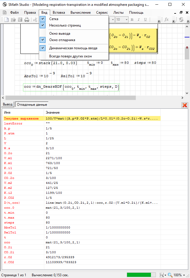

You can set breakpoint on line in D(t,oco) and you will see how values changed.

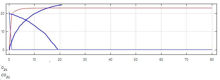

#16 Опубликовано: 24.11.2020 07:24:14
francesco88
francesco88
Yes, I have to study a little bit about this function of smath...to be honest, all the functions!
In general, there is something that doesn't work properly, because the chart describes the depleting and the increment almost linear until the O2 don't reach 0. After that point the CO2 increment start to being described in a "realistic way

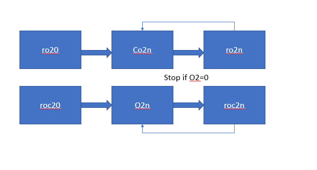

I mean, I'm expecting to see something like that (the thick blue lines)
Veniamo da molto lontano e andiamo molto lontano! Palmiro Togliatti
#17 Опубликовано: 24.11.2020 08:03:32
You need to set real values for all variables. It is not entirely clear from the article what values to use. I can't help here, because I'm not familiar with this task.
I have demonstrated how you can solve this problem. Now you just need to correctly describe it in terms of the program. I wish you success.
#18 Опубликовано: 24.11.2020 08:06:57

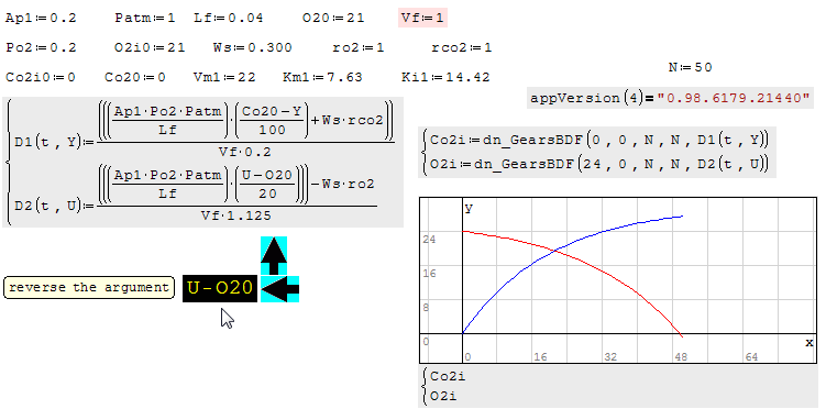

#19 Опубликовано: 24.11.2020 11:06:59
Like this ??? ... freak parameters at will .
#20 Опубликовано: 24.11.2020 11:36:51
... up to You the expert !
Prova modello permeabilita.sm (129,71 КиБ) скачан 1179 раз(а).
