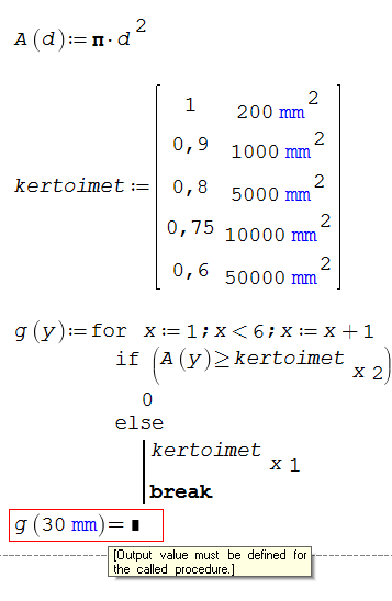

I'm trying to make a function return a value from a matrix by running a small for-loop inside the function. How should I write it? Couldn't find examples how to use it.

Hi Mikko
The loop syntax needs tweaking, and the output variable needs to be defined. The attached file works for me.
kertoimetTest.sm (4,72 КиБ) скачан 1311 раз(а).
Hope this helps.
Brian

Thank you!!!
