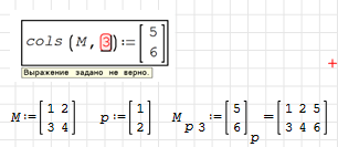

And what about the last Mathcad operator?
#5 Опубликовано: 26.04.2023 01:23:56
There is no desire to repeat the functionality of Mathcad completely. This is a different program and it has its own users. So far, no such operator has been required.

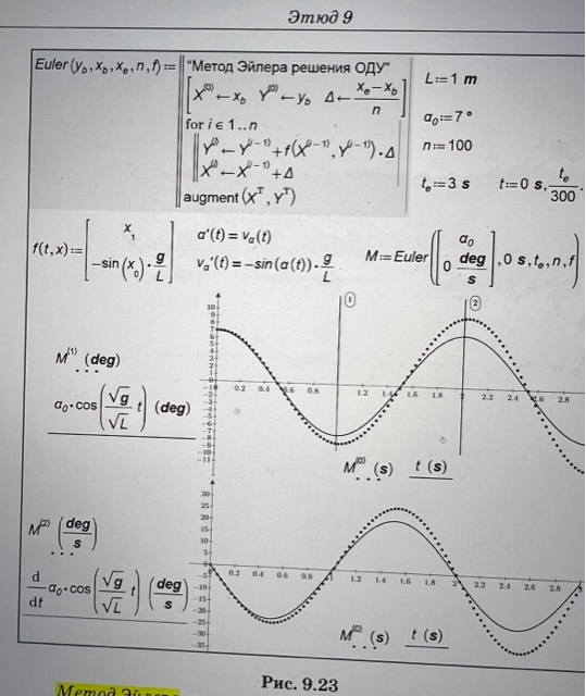

У меня есть целое практическое видео, где показывается метод Эйлера в SMath Studio. Причём здесь last?

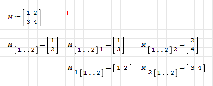

#11 Опубликовано: 26.04.2023 04:32:50
... And what about the last Mathcad operator?
Matrix handling in SMath is more similar to Matlab than Mathcad.
I need
Click to enlarge
Euler.sm (26,06 КиБ) скачан 1563 раз(а).

#12 Опубликовано: 26.04.2023 10:54:15
Euler companion ... and more.
ODE Euler Multitask.sm (128,98 КиБ) скачан 1681 раз(а).
