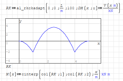

I have no idea why mathcad plots that segment faulty.
But it is possible to plot correct graphic in SMath.
However SMath integration is not very good and fast.
It will take much more time than mathcad, and zig-zagy.
You can improve plot by increasing Integrate: Accuracy.
It is in Tools>Options>Calculation.
PS: I increased accuracy to 500 to get a decent plot.
It took 50 seconds to plot in the picture!!
Integration should really be improved.

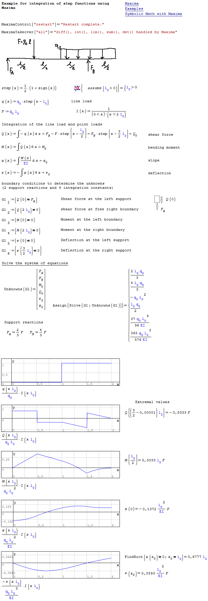

In the interactive handbook you can find examples for beam analysis.
They use symbolic integration and equation solving with Maxima. This is very fast, except for the Maxima restart at the beginning of the sheet (can be removed if all works well).
example maxima beam.sm (41.78 KiB) downloaded 1529 time(s).

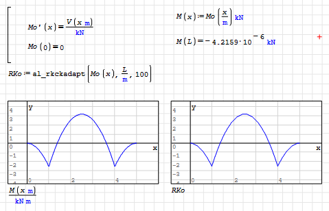

Hi. Remembering that solving an ODE is also told to integrate it:
UDL.sm (22.97 KiB) downloaded 1072 time(s).
The domain can also be restricted to M(x) by multiplying it by the corresponding inequalities.

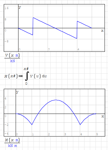

Finite Differences [FD] is a very good yardstick insensitive to noise.
It that what you mean moment at the end ?
Cheers ... Jean.
Page2 FD.sm (57.85 KiB) downloaded 1241 time(s).

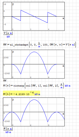

Maybe I am wrong but I think formula should be like this.
Huge kN*m values appear if calculated as in the picture above.

WroteMaybe I am wrong but I think formula should be like this.
Huge kN*m values appear if calculated as in the picture above ...
Hi overlord. You're absolutely right. Thanks for catching that error. Only 3 orders of magnitude. Who could worry about that? The Mathcad block can also be used, although I don't know if this is the best way to deal with the units, using an intermediate function Mo.
UDL.sm (26.96 KiB) downloaded 1077 time(s).
