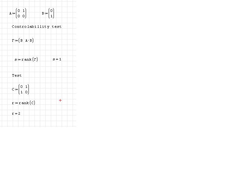

The comma's are from my Scilab equation, sorry about the confusion. It looks like my problem is in the way I calculate the matrix. Attached is a quick test I put together.

You have made an error defining Γ
You need to use the augment() function; without this function you create a nested matrix.
BTW there is a bug because calling directly the rank function when the first matrix element is a nested matrix, a type conversion error appears.
