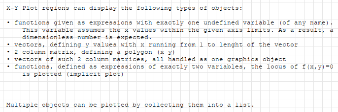

It will plot not only integers, numbers actually.
But plot expect them to be dimensionless.
Not just X-Y plot, built-in 2D plot also.

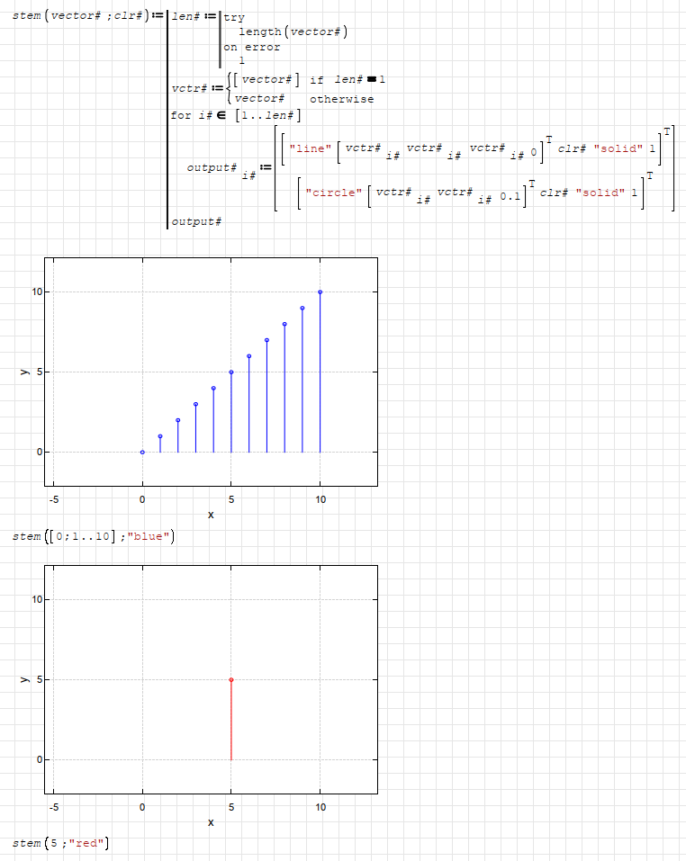

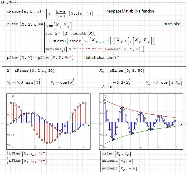

I don't know if there is a stem equivalent for smath plots.
But you can create your own function for that purpose.
stem.sm (8.62 KiB) downloaded 944 time(s).
Here, integers are the X direction.
Eventually, easy for the Y direction as applicable.
