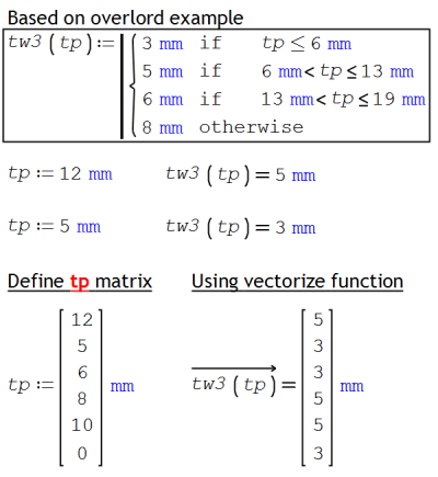

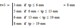

All,
I am new user, need your help how to create this type of equations in Smath

#3 已发布: 2023/6/15 11:42:20
NDTM Amarasekera
NDTM Amarasekera
130个赞,共352个帖子。
Based on program by overlord.
if_function_ndtma.sm (27.85 KiB)已下载 1392 次。

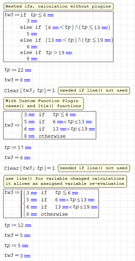

#5 已发布: 2023/6/16 06:54:18
983个赞,共6,866个帖子。
... from the drop down fx menu.
Making it a function as Amarasekera did is much more sensible solution.
