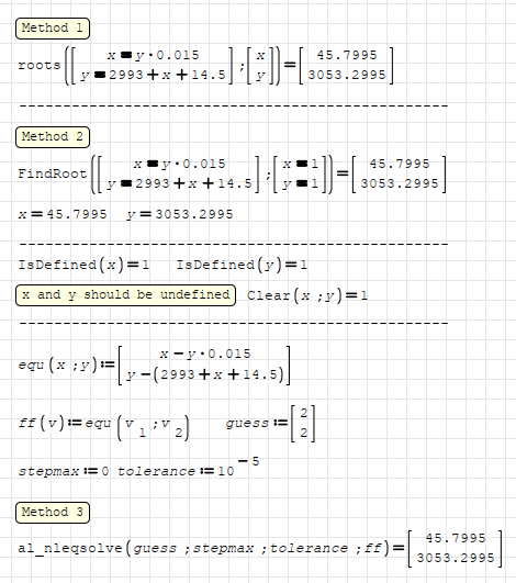

how to get the result of x, y without using the matrix? I tried solve and findroot, but can't get the value of x, y.
You can't use solve() for nonlinear equations. (more than one unknowns)
You can use roots(), FindRoot() or al_nleqsolve().
Here is your equation solved in various ways.
solvers.sm (10.77 KiB) downloaded 1007 time(s).

FindRoot is better for my condition, I need units.
Thanks Overlord!
