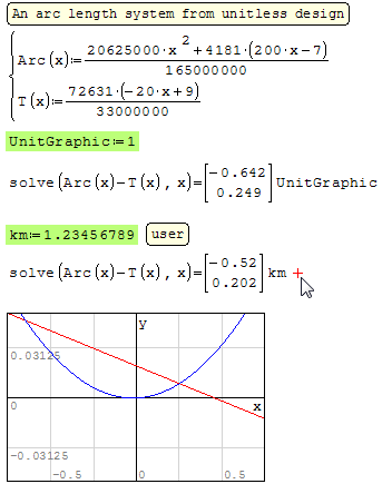

Solve() from the Maxima plugin can handle units directly (symbolic solver)
2019-01-28 14_26_49-SMath Studio - [Gelzbetonines%20konstrukcijos%20ilinkio%20skaiciavimas.sm_].png
frapuano 2019/1/28 12:57:00
