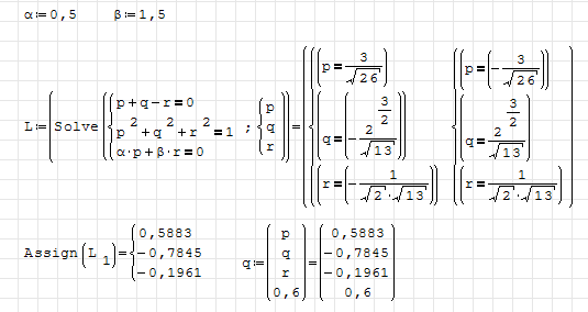

"Sometimes the Maxima function Solve can replace the Mathcad solution block, see attachment.
