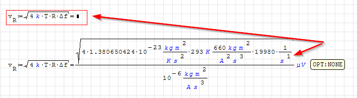

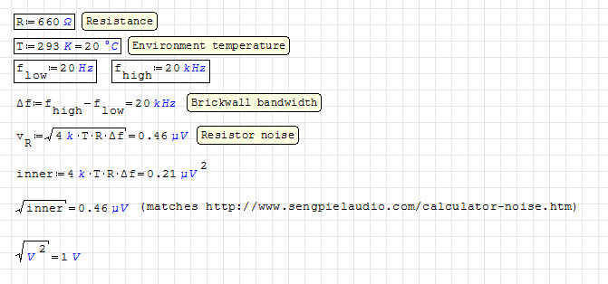

I had a worksheet that worked in the past, but now it doesn't, saying "operation cannot be performed with units", because it's sqrt(V^2)? But if I break it up into two steps it works:

yes, it works in the Nightly build. thanks.

Actually, no, the original worksheet is not working, only the copy that I uploaded

I've already seen this bug, sometimes comes to light...
when the SMath engine output unitary exponents on units, square root fails.
Refreshing the worksheet alternately works/doesn't works.
[EDIT] Added in the BTS: SS-177
