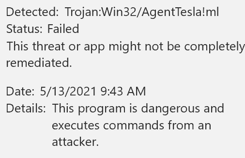

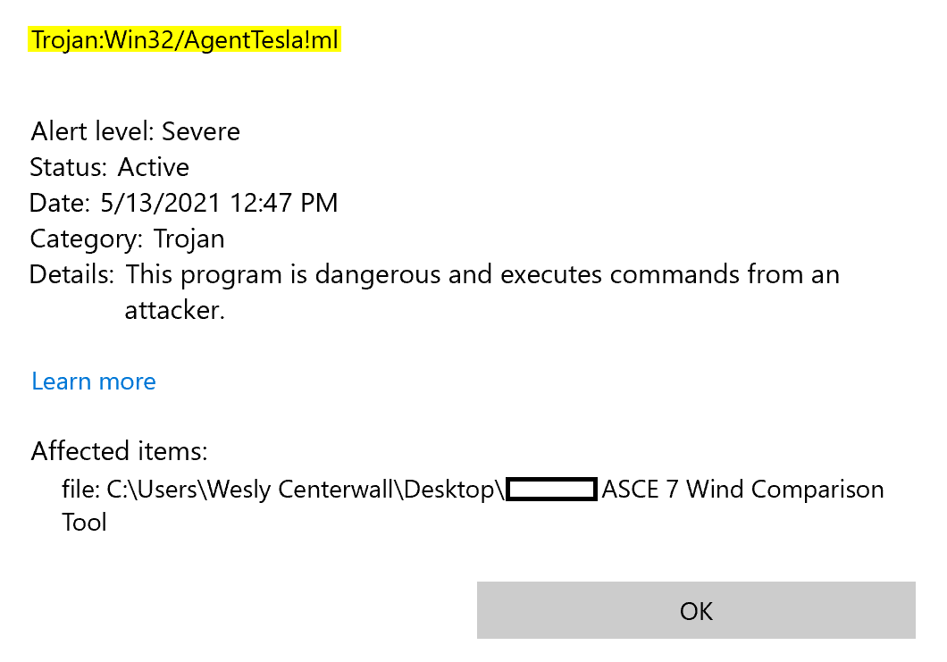

I'm getting a virus issue when I save an exe in the full version.
The file seems to work fine on the computer I created it on, but when I send it to another PC, windows defender blocks it and detects the trojan Win32/AgentTesla!ml.
Not sure how to handle this. I can't distribute exe files like this.
*when I send it in a zipped folder via email.
False positive. Anti-virus software sometimes do not like when programs creates other programs. You have to contact to your anti-virus vendor or exclude such programs from scanning.
Unfortunately I can do nothing with it.

Just an update. I transferred the file with a flash drive instead of email and there is no issue at all. No virus detected, no unknown program warning, as it had worked in the past.
I was using the native windows zip feature, maybe that had something to do with it?
Thanks for the quick feedback Andrey.
#7 已发布: 2021/5/13 13:56:47
26个赞,共155个帖子。
Alright, did some more testing and no matter how I send the file (removed extension, fake extension, zipped, file share download) windows is still detecting a virus.
How are we supposed to share our exe files if they get blocked as viruses? I don't remember this being an issue before as I've sent several of my exe files before without issues.
I'm using Windows 10 and cannot reproduce this issue. Are you sure your PC has no viruses which could break exe files generated by SMath Studio?
#9 已发布: 2021/5/13 14:27:40
26个赞,共155个帖子。
I'm running win10 as well. No viruses. Try to zip an exe and sent it to another computer running windows. Remember, this is not a problem for the computer where I made the exe, only when I share it.
By the way, the exact same exe file copied to to the other computer using a USB drive has no issues at all. Only having issues when the exe comes off of email or is downloaded.

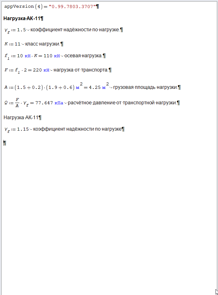

Problems with copy and paste in document mode
#17 已发布: 2021/5/14 10:03:19
127个赞,共342个帖子。
I confirm what is indicated by Denis, even in my installation
Yeah, it is a known issue - copy/paste of content inside Text Region is not implemented yet (except simple text). I plan to handle it soon.
Thank you!

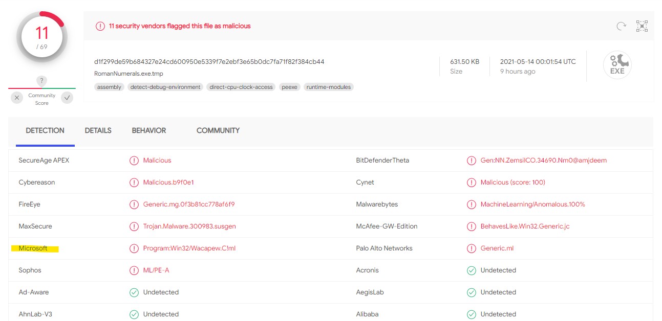

I have some good news regarding false positive detection! After a long night and morning I've found binary pattern which triggers some AVs to mark executables created by Viewer as malicious...

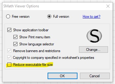

Knowing it I've added possibility to give AVs a fight! Unfortunately I have to disable compression of internal resources to do it, but I do not think it is so bad.
Please try a new SMath Studio version - it has the following checkbox (uncheck -> file size increased -> AVs are happy -> profit):

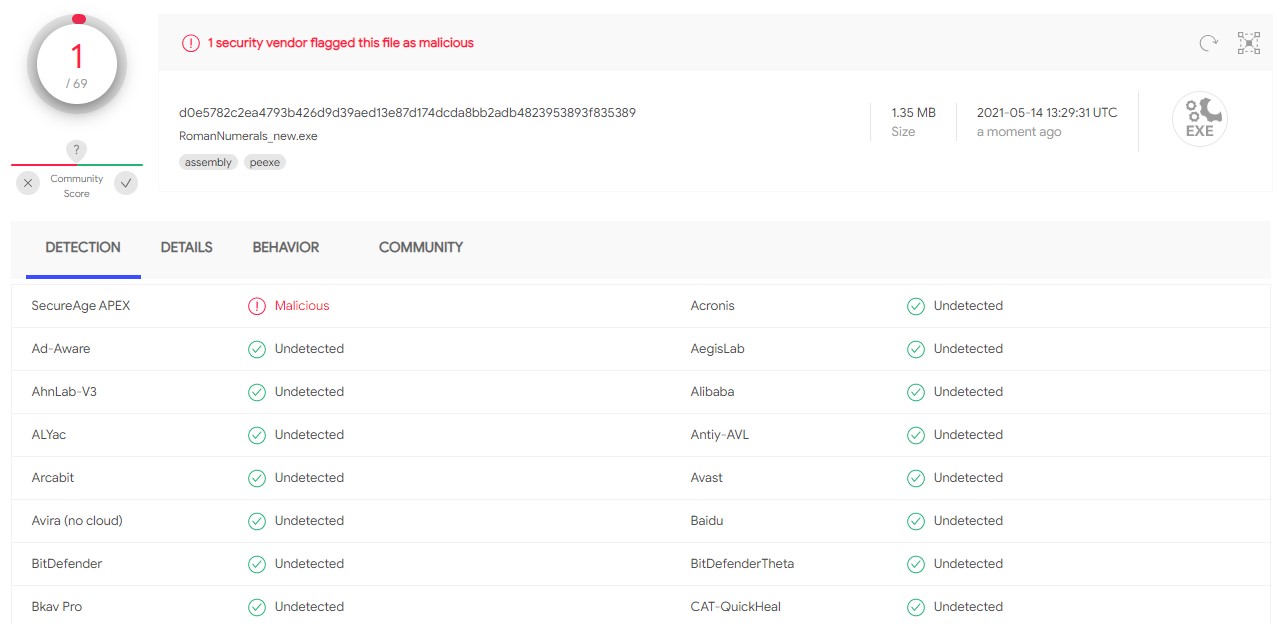

Here are results of testing the output result in VirusTotal:
Before
https://www.virustotal.com/gui/file/d1f299de59b684327e24cd600950e5339f7e2ebf3e65b0dc7fa71f82f384cb44/detection
After
https://www.virustotal.com/gui/file/d0e5782c2ea4793b426d9d39aed13e87d174dcda8bb2adb4823953893f835389/detection
