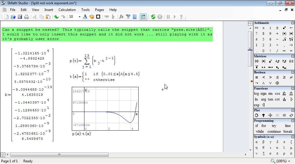

  1. Can a snippet be nested? I have a function "snippet" that relies on another snippet. This file is an example and I want to reference only this snippet function which will embed the other snippet function
  2. Do Snippets need to be saved as SM? I had an issue with my SMZ files which I default to saving everything out of habit. I have not tried this version
  3. Equation wrap does not work on exponents. I know this feature is a work in progress. I even posted a work around
Split not work exponent.sm (14.33 KiB)已下载 1820 次。

User error on the Snippet. Because snippets are static, you can embed one Snippet that calls on another Snippet. I thought it was more of a reference like rfile. I like to go back and update documentation/clarifications as time goes by.
