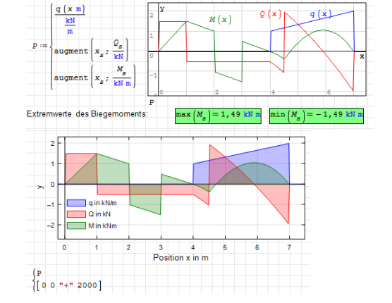

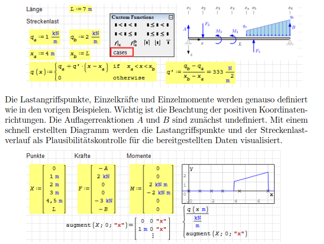

I have just submitted a book on Engineering Mechanics with SMath Studio for publishing. It is to appear early next year. The examples are already available at Github https://github.com/sn-code-inside/Technische-Mechanik-mit-SMath.
See example 5.5.

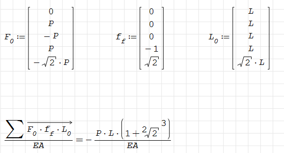

For structural analysis in SMath, using vectors usually works out much better than lists anyway, especially when you start dealing with larger matrices or displacement vectors. It keeps the math a bit cleaner and more consistent with how SMath handles calculations internally. That Engineering Mechanics book example looks like a great resource to keep on hand for these types of workflows too!
