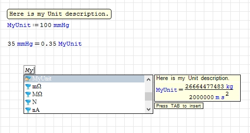

You might use a snippet instead.
These are ordinary SMath files which can be embedded in any other file just by typing their name, usually as collapsed area region. And in ordinary SMath sheets you can define units with descriptions in whatever set of languages.

Hi. I agree with Martin. Also, in the standard way to introduce new units in SMath, you can add your own unit description, again, in the standard form.
I don't check if you can add different description for different languages.
