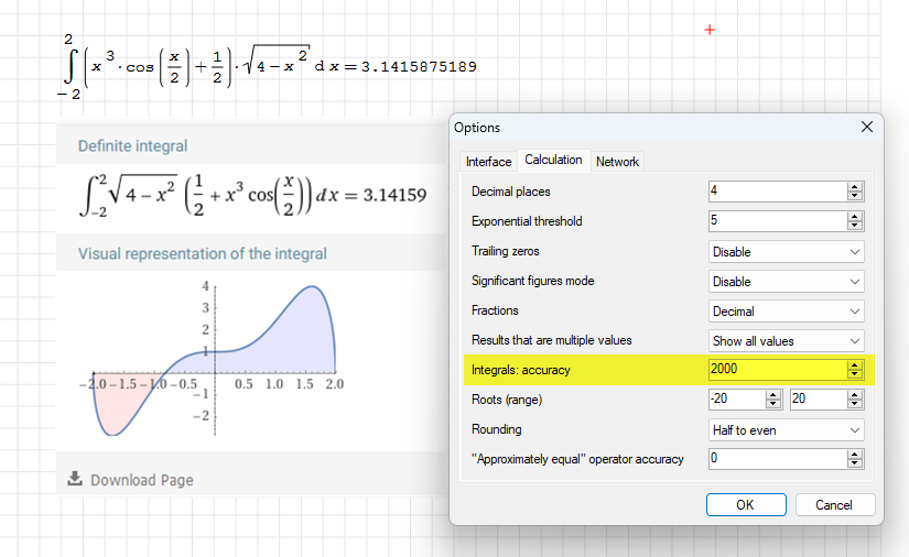

int((x^3*cos(x/2)+1/2)*sqrt(4-x^2),x,-2,2) is calculating incorrect
Wroteint((x^3*cos(x/2)+1/2)*sqrt(4-x^2),x,-2,2) is calculating incorrect
You have to play with the "Integrals accuracy" global setting (Tools > Options... > Calculation)
![2024-04-02 09_46_38-SMath Solver - [Worksheet1_].png](/zh-Hans-CN/files/Download/XCuBgd/2024-04-02-09_46_38-SMath-Solver---[Worksheet1_].png)
