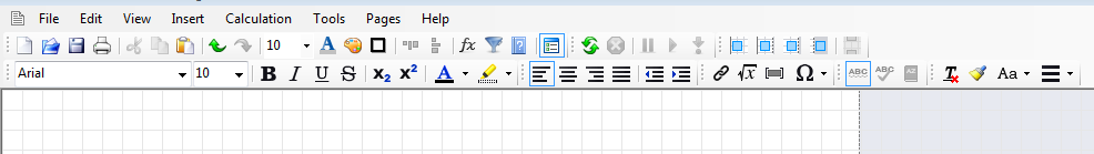

Davide,
Under version 0.98 build 6179 (64 bit) loaded, this plugin does not work as it used to. It used to be that CTR+Shift+W would pop open a "formatting" dialog box (per post #2 "floating toolbar") like the text region utilities. Now it just opens a "text box which is the width of the sheet, but no formatting utilities. Is this because 64 bit loaded up when I upgraded?
PS Same issue with portable version I created with previous version. Can shis toolbar be placed in the side panel with the math/symbols, etc.?
PPS If I left mouse click and go to settings, the floating toolbar pops up. Is there a way to make this the default? (both desktop and portable)
Really strange
Only cases in which you should notice changes are on cleaning of settings folder (but this will load the default settings, that aren't the ones listed by you) or by your choice. Please check your settings in the "More..." > "Options..." menu ("New regions" and "Environment" tabs). Settings should be saved once you click on "OK" and never change, except in cases mentioned previously.

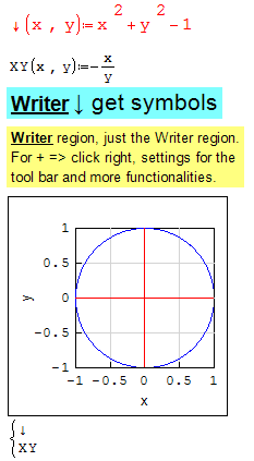

My procedure Win 7, micro laptop:
1. from the insert menu => click the W symbol [insert writer region]
2. the empty rectangle appears [|]
3. click right for the drop down menu => click left "settings"
4. as you start typing in the rectangle the movable tool bar is active.
#70 已发布: 2017/3/8 11:28:07

Jean,
That is the problem! The movable tool bar is active only after doing all that. It used to pop up @ step #1.
#72 已发布: 2017/3/17 11:21:16
1,443个赞,共2,936个帖子。
Have you tried to change your settings?

That is the problem!The movable tool bar is active only after doing all that.It used to pop up @ step #1.
Once you have entered the writer region you have minimal options:
click on a word to Ctrl+B, Ctrl+U [bold, underline].
For the tool bar: click right, click left on 'settings'.
The minimal and advanced options is very ergonomic [to me].
