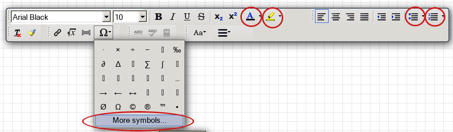

Circled buttons force crash smath on linux.
Bug occurs if I click on little triangles next to items.
I don't know if every linux distro has this bug.

I remember that was tested in Mint and Ubuntu...
If you start the program from Terminal you are able to collect some more info about the exceptions?
