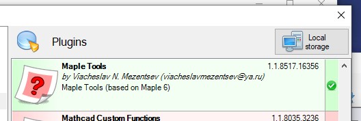

Maple is a Plugin you can install:
To expand off of [USERLINK]Razonar[/USERLINK]'s post; 🍁Maple has several functions, another ̶o̶n̶e function you can use is "solve": you can evaluate the equation symbolically:
